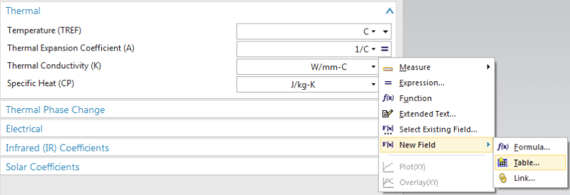

I want to add a new isotropic material. I know how to do it, but the problem is the thermal expansion coefficient should follow a parabolic trend, y=x2. I'm not able to figure it out. I'm using NX10.

In the thermal expansion coefficient box, click on the equal symbol > New Field > Table
Next, define the CTE table value with respect to temperature.

Hey Tuw,
1.That was really helpful. Thanks.
