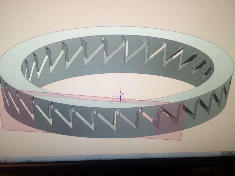

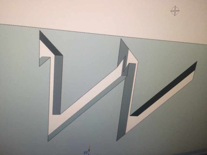

I wanted to create a continuous channel on the inner surface of a hollow cylinder, like pic 1. The channel can be treated as a pattern repeating itself. I tried to create a sketch then extrude cut, then pattern it, it doesn't work well since the continuity of the pattern, it's hard to have the end meet the start, and there are always corners that remain uncut, you can see it from pic 2.I was wondering if there is a good way to do that?

Can you provide at least a picture of what you're trying to model?

I'm not sure of all your requirements, but attached is a file showing a couple of ways to make the channel. You can turn off the Offset Region and turn on the Thicken and Subtract to get either a channel or split the body fully.
