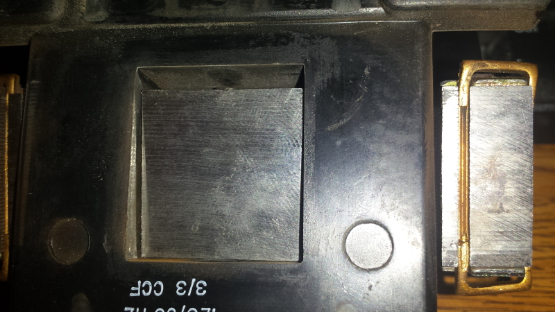

Hi Folks
Any alternatives to this unit, they are obsolete now and very expensive ($4000.00). My armature volts is 240V and 89A. The problem with these I think is the small copper square ring around the laminated plates, this ring cracks or opens and I'm thinking it is the culprit causing the contactor to chatter. I have spot welded the ring with good results but would like to just find a newer unit to replace these, we have three. Currently checking into an AB product.
Recommendations anyone?
Thanks, Chuck

This is a pic of my iron with broken ring, not sure what the technical term is of course.
RE: Alternative for Joslyn Clark DC contactor for braking resistor.
The technical term is a "shading coil", and yes, if it breaks, the contractor chatters.
Joslyn Clark still exists, but is this PARTICULAR contractor obsolete? 240V DC rated contractors should not be too hard to find, but harder than they used to be as DC falls out of popularity. Be careful though, the contactor must have a DC current rating, you cannot assume that an AC contactor without the rating for DC will work, DC is much harder to switch.

Most shading coils are set into a sight machined groove around the iron from about1/8" to maybe 3/8' from the end. I have seen homemade coils that worked. Take a Cu wire about the same size as the shading coil, cut longer then needed clamp the 2 longest to the iron. Lay the shorter cuts across the top of the longest cut. Then braze or silver solder asc close as you get without hitting the iron. Remember the need to be tight against the iron.

Thank you Gentlemen! I will make some calls today, a spot weld/w wire feed temporarily saved the day.
