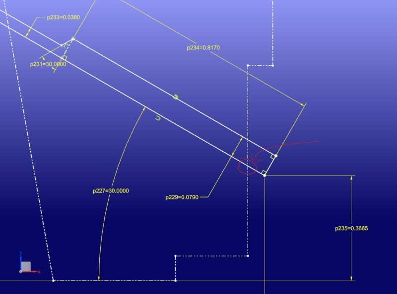

Does anyone have any insight as to why you cannot dimension an intersection in sketching? (using NX9)
RE: Sketch, dimension intersection
Create a Sketch Point at the intersection of the two curves and then you can create constraint dimensions to the Point object.

FWIW,
If you create the corner first & dimension it, then round it with a fillet/radius, the Sketecher will create the intersection/point for you.

Xwheelguy,
My situation was a little different than that. See attached image, the intersection circled in red is what I actually want to dimension to. If I didn't extend the profile beyond the part I would obviously be left with a little sliver that wouldn't get subtracted.
