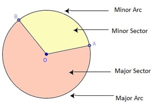

peakpilgrim - I see, you do have a challenging project. With those restrictions you certainly don't want to commit to placing too much concrete at one time. Consider making concrete placements as minor sectors of a circle:
In principle, screeding would be performed radially (Line "AO", sweeping on the minor arc to Line "BO"). See if this is practical for you project. There may be complications because of underflow collection details and piping at the center (Point "O"), but you should be able to work around that.
Depending on the workforce, four or more sectors may be best. The sectors do not all have to be the same size. Perhaps begin with a small sector to see how things go, then adjust the size as experience dictates.
Concrete slump will depend on the mix design. Of course you will need a fairly "stiff" mix. Because of the limitations you have, it may be worth making some test placements on a simulated 6:1 slope - both to select a suitable slump and to train the workforce. A "rule-of-thumb" that my father taught me is that structural concrete should be able to flow down the discharge chute of a concrete truck by gravity alone. Any mix with lower slump than that will cause more problems than it will solve.
