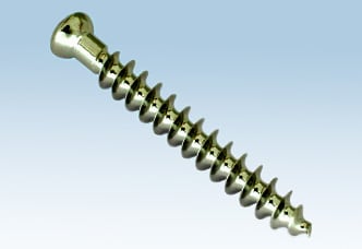

I'm R&D manager of a bone implant manufacturing company,
We recently produced 1000 screws using Thread rolling method but they didn't get approved and we recalled them,
The reason was 'Residual stress' how to release the stress by non-thermal method.
RE: Urgent question, Residual stress
From the picture provided it appears there was a fairly substantial amount of cold-working involved with roll forming those threads. You did not say what the material used for the screws was. Some materials actually benefit from cold-working. Why wasn't a thermal stress relief process acceptable for these screws?
The material is Medical Grade 316 stainless steel, Known as 316LVM (Vacuum-Arc Remelt).
my main concern regarding thermal stress relief is the possibility of unwanted transformation of metallurgical characteristics of this type of steel.
Another problem is that the core of the screw contains voids after thread rolling, while the raw material is defect free.

This 316 cres material will likely work harden from this thread rolling operation. Voids in the material after thread rolling will not likely be an issue, but due to the amount of material displaced you may see some problems like cold laps or tears at the thread tips. These conditions can be detected by an NDI process like dye pen inspection.
For bone implants, no stress relief is going to correct the problem of "voids", which would be a serious issue in bone implants due to the possibility of fracture during service. I think you really need failure analysis performed by someone experienced to tell you what is really going on.
As tbuelna already mentioned, voids due to cold forming are very unlikely.
Better to start with an identification of the exact problem (as said, (micro-)tears and cold laps are very well possible). Once the problem is correctly identified, you can adapt your production process to avoid these defects.

What is the reason for stress-relieving the screw after thread rolling? Is dimensional stability or corrosion resistance an issue?
Given the degree of mechanical working involved, there may be some amount of strain-induced martensite after thread rolling. But I think it would require a full solution anneal heat treatment to transform any martensite back to austenite.
The internal voids could be fissures from too high of external pressure during rolling. After all cross rolling is how they pierce solid bar.

I don't understand how the rolling process can introduce voids, unless there's delamination in the core material occurring due to friction.
Would I be correct in assuming that the issue with residual stress is stress corrosion cracking as blood is fairly corrosive due to the proteins/enzymes? I do know that for bioengineering applications, carbides in the steel are a no-no as Chromium tends to be a trifle cytotoxic when the carbides dissolve.
A stress relieve anneal would fix this, but I'm not sufficiently knowledgeable of the behaviour of this grade of stainless to comment on the interactions occurring at 450*C
akhb76,
That image shows a bone screw with a deep buttress thread form such as Type HB from ASTM F543. That type of thread form is manufactured by chip removal processes such as thread whirling, rather than deformation processes such as rolling, due to the large strains that would be required. The large amount of plastic deformation is not possible on a routine basis using today's engineered materials, as they will form defects like laps/folds, severe adiabatic shear bands, etc.
