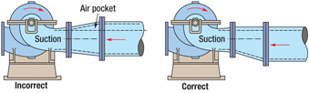

What kind of reducers are installed in pump suction and how are they positioned?

Dejan, the reducers are 80mm>50mm on the suction. Between the suction valve and the reducer, there is a suction strainer also (see drawing for reference).

I had a look...the eccentric reducer does have the flat side on the bottom..and the supply line to pump suction is flat - coming straight off the bottom of the water tank at the same elevation.

The reducers are eccentric, bottom flat for both pumps.

Your reducers are upside down if the flat side is on bottom. Look at the picture and article supplied by Bimr above.

If you turned the eccentric reducers around, the problem would go away.

RE: Air in centrifugal water pump
jlbish,
as a result of the configuration between the minimum flow lines from pump 'a' and pump 'b', is there a possibility of a venturi effect where the pump 'a' minimum flow line when operating is sucking fluid from the pump 'b' minimum flow line? after some time the water will be vacated from pump 'b' and air introduced through the pump 'b' seals. this would not be the case when 'b' is running and 'a' is on standby.
arthur
