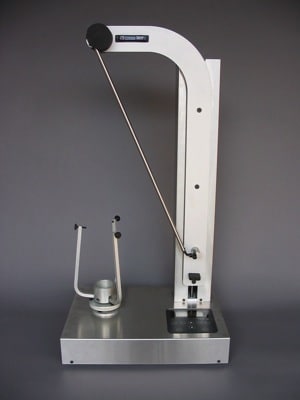

Starting to draw up plans for a affordable digitizer for use in prosthetic work in low-income settings. The primary function will be to trace the inner surfaces of plaster casts taken from client's residual limbs, converting them into a 3d-surface for computer-based model rectification and potentially CAD/CAM fabrication.
For those of you not quite familiar with the prosthetic fabrication process, imagine a machine that must digitize the inner surface of a unique, hand-made piece of pottery. My basic design is based upon commercially available designs for prosthetics such as this.
The basic idea is to use mount the cast on a turntable, and use a spring=loaded probe arm that ensures contact with the inner surface that is slowly raised out of the model to create a helical group of points (via rotary encoder data) that can then be converted into a 3D-surface.
My thought is to use a basic traveling-nut lead screw design for the vertical translation of the probe - this should be relatively low-cost, and is "geared" in a sense, such as to reduce drift or frequent deviations from calibration. However, ideally I would like to have a "quick-release" feature that quickly and easily allows the probe to be initially placed in a vertical location, and the re-engaged to start the scan. I've done a bit of research and only found a handful of somewhat related features (such as this). Not sure though if this devices fit the application (they also note not for vertical use). Am I barking up the wrong tree with the leadscrew design if the quick-release is a must-have? Or are there simple ways to overcome this "quick-release" that I am overlooking? Any help would be great.

RE: Quick-release function for traveling-nut actuator?
Do you need the power transfer that a leadscrew design offers?
Could you attach your carriage to a belt with a driven pulley at the bottom and an idler at the top? Options for resetting the device could then either be to unclamp the carriage from the belt, or to loosen the idler to allow the whole lot to run free.
A.
Thanks for your insights, a thoughts regarding some of your comments:
zeusfaber: no, power transmission needs will be pretty minimal ( < 5lb I would guess). The leadscrew does however give me good precision (I'm thinking digitising will be done in/around 2-4mm per slice/rotation, so probably need < .5mm of error/backlash), and it maintains its position even when power/force is not applied. Do you think I could get these two qualities out of a pulley system?
tygerdawg: have definitely been impressed with some of the optical systems available, and have spent a significant amount of time trying to find something that fits the implementation. Unfortunately most the "budget" options (< $1K is desired budget) tend to lack the precision (studies have estimated a radial precision of < 0.5mm is needed), accurate scan of small curves, and ability to filter out slight movements in the residual limb during scanning. Your thought of casting, then scanning a split cast is interesting, although doesn't necessarily solve the precision/small curve issue, and the phrase "semi-automated stitching" on the site worries me a bit about getting an accurate mate.
On a note related to the original concept of the leadscrew design, do you think it possible to use a half (~180 degree) section of a tapped hollow shaft rather than a nut to interface with the screw shaft, which is held in place by spring tension, or would this send my backlash/error through the roof? Just thinking then the user could release spring tension to slide the device for quick placement (would use a smooth guide rail as in CNC use to maintain alignment). Another question is whether this type of piece would even be easily machined?
If you need extreme accuracy (I still think you do NOT..."<0.5mm of error" is quite fat) then a ballscrew affair is a good choice. Else I'd use a timing belt / pulley system with proper gear ratios and a small microstepper motor. Relatively low price, easy assembly, good accuracy, minimal or no backlash, very controllable. One of my favorites is Schneider Electric's Intelligent Motion Systems products from www.imshome.com .
My first thought was a split nut like is used on lathe carriage feeds. A quick quarter-turn of a lever releases the nut from the screw. https://youtu.be/yqYd2-52R5U
