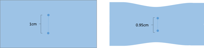

Is there a way to create nonlinear displacement constraints? In the past I have used constraint equations to control displacement (interaction module>>constraints>>create>>equation) but this method only allows you to enter a linear relationship.
In a simple example what I would like to do is be able to take two nodes in a 2D plane let’s say 1cm apart initially. Then prescribe for the first load step that now the two nodes must be 0.95 cm apart, as a result the structure around this two nodes would deflect. Basically instead of applying loads I am applying displacement constraints. The constraint equation for this example would look like:
0.95 = sqrt( (N1x-N2x)^2 + (N1y-N2y)^2 )
The common quick response I get to this is just use displacement BCs. But I don’t know where the two nodes will be (that is what I am solving for), all I know is their initial location (and therefore distance between them) and there final distance between them.
Ultimately I want to do this for more than two nodes and on a larger scale, but I don’t want to muddy the waters. If I can get this simple example to work I will be set after a little scripting.

Below is an image of a simple example, I need to be able to directly control the displacement/strain between the two nodes. For instance I have thought that I could simple connect the two node of interest with a truss element, then if I could specify to truss element to strain X amount I would be business. But as yet I have not been able to find a 2D line element that I prescribe the strain of. Certainly I could use disp-BC to tell the ends where to go, but that does not solve the problem.
I could use a truss element with expansion then change the "temperature" except this does not give direct control of strain. The resulting strain would be a function of the delta T and the stiffness of the "truss" material and the stiffness of the surrounding material.
I am aware this example could easily be solved the symmetry, the end goal is not so simple so that won't work.

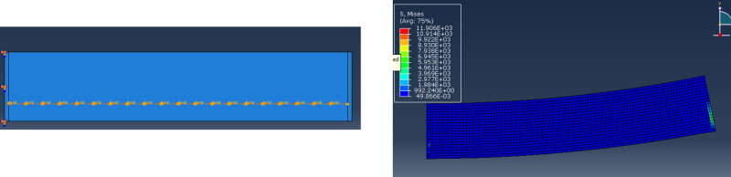

I went with your first option, which still had the same problem, if I assign a force the resulting displacement/strain is a function of the force the the structure around the connector. Example I would not get the same strain if the connector was in rubber vs steel. But I discovered I could use a "Connector Displacement" BC to enforce the displacment.
I took the line which I wanted to be the extending actuator partitioned into equally spaced units and then created many connectors. The connectors are basic transnational only connectors. I did not define any properties like elasticity to them, they simple exist. Then apply the BC and voila. The case shown below is a simple line but I can make curved lines and still only have to input x.x displacement of the connector and due its definition I get the desired behavior.
Now my question is how do I determine how much force it is taking to enforce the "Connector Displacement" BC.

Sort of found my own answer FieldOuput>>Connector>>CTF
But when I blot the whole model goes gray. The color scale gives a range which seems okay for the force, but I don't have any way to visualize it because the connectors have zero area and can't be rendered like beam and shell elements. I can plot the values of force in the XY plotter, and it tells me the element number and the value. But I would have to go back and looked up each elements location to make sense of the data.
Thoughts?

Thanks, again it was a combination of things. I got the correct output, the trick to visualizing was:
ODB Display Options>>Entity Display>>Show Constraints.
