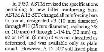

Square bars weren't used 60 years ago (i.e. 1955) that I'm aware of. Square bars were used much earlier, which is what CTW's link indicates:
RE: Rebar Corrosion
It is definitely round bars. I think in Ontario the square bars were mostly used before the war.
