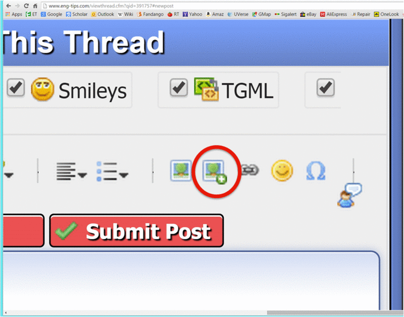

I wish I could post screen captures here.
RE: Cannot get output from my Eurotherm controller
"I wish I could post screen captures here."
You can; the button below does that
TTFN
[IMG http://tinyurl.com/7ofakss]
