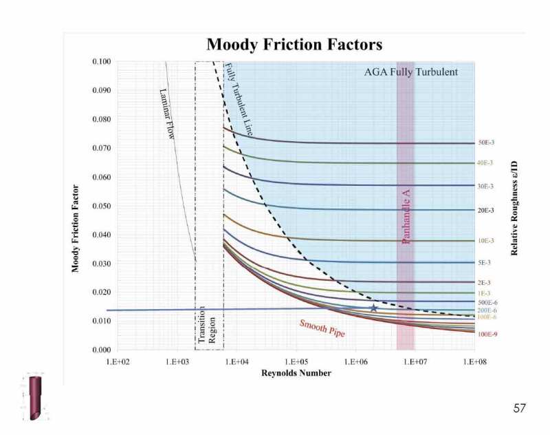

SNORGY,
Even though I am often the prissy, picky "expert", I used to do much the same thing. Now, when I have to face some jerk as pedantic as I am I show them the results from the Isothermal equation and a list of the things about my problem that make each of the various equations invalid. That happened often enough that I developed this graph for AGA and Panhandle A (I have other graphs for other correlations, this one is kind of the Moody diagram, but I hate Moody's logarithmic y-axis)
