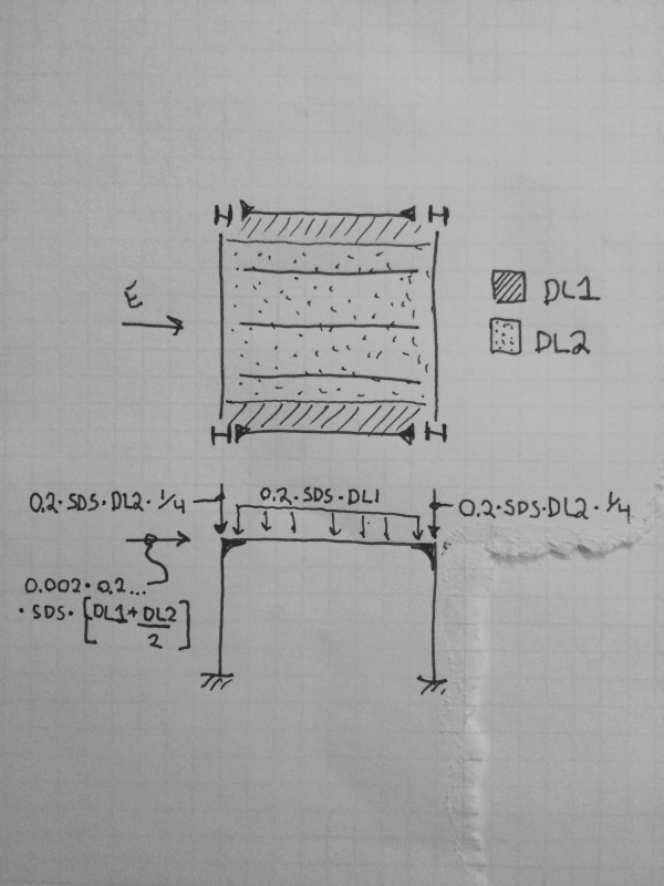

This is an interesting question. And I think that RobertHale nailed it. I believe my sketch below to be a graphical representation of RobertHale's suggestion. You would take the seismic amplified dead loads shown in the frame elevation and plug them into your usual load combinations.

RE: Confusion Regarding the Dead Load in ASCE Load Combination 5 and 7
Quote (JAE)
KootK - Not sure about that.
Me neither. I welcome the debate.
Quote (JAE)
Does bringing in D3 in your sketch, and using it to add to the lateral seismic effect E, follow the intent of what 0.2SDS(D) was meant to do?
In my mind it does. The whole building tributary vertical seismic load (WBTVSL) generates a lateral load on any out of plumb columns that rely on the moment frames for lateral stability. The WBTVSL also adds to the P-delta burden on those same columns. If this effect is accounted for elsewhere in the process, then that's news to me. I feel that it should be accounted for somewhere, however.

Your approach, like mine, already includes the destabilizing effect of the WBTVSL on the P-delta burden.
[1.2D + 1.0E] = [1.2D + 1.0Eh + 1.0Ev] = [1.2D + 1.0Eh + 1.0 x 0.2SDS x D] = [(1+0.2SDS)D + 1.0Eh].
As your 3D model moved laterally, [0.2 x SDS x DL_[whole building]] would be contributing to P-delta instability I think. The difference with my approach is that I would add (0.002 WBTVSL) to the notional loads.

It's also worth noting that 0.002 x 0.2 x SDS x D is about equivalent the wind pressure generated by the flap of a butterfly wing. That part gets lost in the noise. Even I wouldn't bother if it didn't fall out of a spreadsheet automatically.

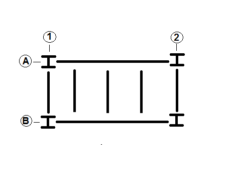

@wonnabeSE
for the 1.2D, the D is the dead load the member is supporting.
for the 0.2SDSD, the D is the dead load that's causing the seismic lateral load.
They DO NOT have to be the same D. If they are not the same D, (1.2 + 0.2SDS)D + ρE + L + 0.2S does not apply.
For a simple example:
The floor dead load are supported by Beam A and B, not by 1 and 2.
Designing Beam 1 and 2, the 1.2D is only their self weight. But the 0.2SDSD is from half of the floor dead load plus the beam self weight.
(1.2 + 0.2SDS)D + ρE + L + 0.2S in this case I think do not apply.
Here's my interpretation of how your example should be handled Azureblue.
You are right. I thought the dead load in DL2 would have vertical seismic effect in Beam 1 and 2. Now I think about it, they would only affect the columns and Beam A and B, not 1 and 2. Although, in practice, the floor is probably one piece and Beam 1 and 2 would essentially receive some vertical seismic effect from DL2; it's conservative to design Beam 1 and 2 for it.

So is this agreed upon then? It appears Kootk's sketch on 22 Jul 15 21:03 follows what was done in an AISC seminar on Stability "Stability Design of Low- and Medium-Rise Steel Buildings (By Don White). Atleast I think it is similar, I haven't had time to really go through it.
EIT
www.HowToEngineer.com
I'd say so with the understanding that the "vertical seismic notional load" component is meaningless numerically and quite possibly not the intent of ASCE-7.
