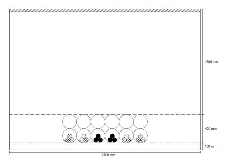

If that sketch shows the phases running in an A-A-B-B-C-C configuration you should reconsider. Put one cable from each phase in each duct.

Let’s say 6 pvc duct of 6” [168 mm outside dia] 250 mm center to center line distance
Let’s say cable of 30 kV 300 mm^2 copper conductor XLPE insulated shield grounded at one end.
concrete 1 k.m./W earth 0.9 k.m./W 25oC 1.75 m depth concrete duct bank 300*1500 mm.
The maximum allowable current per one conductor 320 A.

RE: help for electricity distribution (HTA) through underground cables (6 circuits)
If ROC=ROE then TEARTH will be TCONC where instead of ROC you will put ROE. The second part will be 0.
Since you have 2700 mm available trench width you may keep 450 mm distance center-line-to center line but since the conduit stays directly on sand the sand will dry and it is indicate to take 2.5 k.m/W earth thermal resistance. See 2.2.6.1 Buried troughs filled with sand.
So the above cable maximum permissible current [ampacity] will be only 220 A.

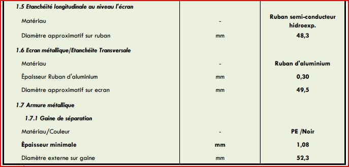

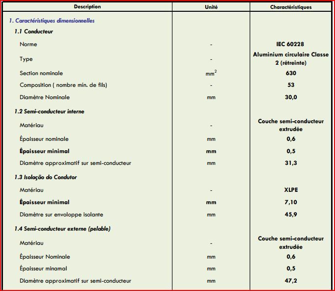

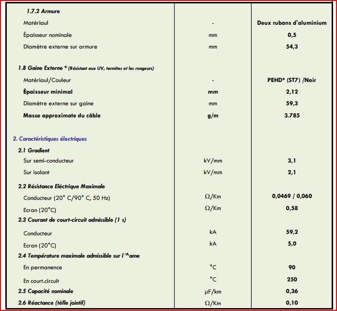

cable Characteristics
In my opinion, if 1280 A it is the total phase current, it seems to me o.k.[I did not follow quite your calculation but it seems to me earth resistivity it has to be 2.5 k.m./W –not 1.5.]

In my opinion, if the cable is as in attached table and the conditions are as you described it:
-1.8m center line conduit depth, 50 Hz, 1.5 k.m/W, 25 oC,6* 8" pvc conduits,450 mm appart-
then you'll get 303 A ampacity per cable that means 6*303=1818 A/phase.[the maximum temperature of 90oC will be of no.3 and 4 conduit conductors.]

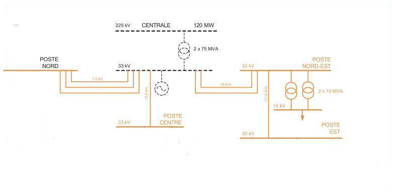

here is my power circuit
the specifications mention that 30MW should be carryed to the North post(poste nord)
but 303A isn't enough
The three phases happen in the same duct (1 duct contains 3 cables== 1 circuit).
Circuits are buried together in the power station then they are separated to be diffused in their designated post.
The north post is connected to 3 circuits.
So if one circuit contains 495 Then the three same circuits will contains 3* 495= 1485
= => S=SQRT(3)* 33*1485=84,87 MVA
AND P=67,9 MW
It is true??
