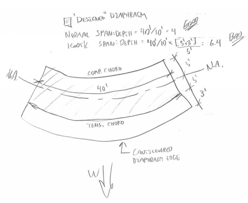

@RFreund - I do not consider them cantilevered if they are 6 feet or less, and I generally will only use this approach if the plan offsets are minimal, say 1 or 2 plan offsets per flexible diaphragm. I will sometimes add an additional shear wall perpendicular to the corridor to limit the number of plan offsets in a given flexible diaphragm. The value of 6 ft. comes from the updated cantilever diaphragm provisions in the 2015 SDPWS. In my opinion, it's easier to add another shear wall than it is trying to detail a cantilever diaphragm off a main diaphragm. We have had issues with multiple member collectors and how they line up during construction, specifically trusses that share a 2x4 load bearing wall.

I believe that the purpose of diaphragm span to depth ratios may be to limit the amount of inter-panel axial strain developed between the sheathing panels that we assume do not participate in resisting flexural tension and compression stresses. Consequently, I've been calculating a modified span to depth ratio for diaphragms that have overhanging sheathing beyond the chord members as shown in the sketch below. I think that, calculated this way, the axial strain in the sheathing should be equivalent between diaphragms with and without overhangs. I compare these values to the code limits and assume that they're okay if that checks out. And yes, this is pure KootK fiction -- no code basis to speak of.

Quote (RFreund)
Let's call the rectangular diaphragm bounded by the most interior, exterior walls and/or the truss/blocking between them, the main diaphragm. So your plan offsets create areas of the diaphragm that our outside of the main diaphragm. When looking at forces parallel to the corridor walls - Do you consider the offset portions a cantilever diaphragm where you transfer shear at the previously mentioned trusses/blocking and develop the chord forces into the main diaphragm?
You're both talking about the phenomenon shown below where the chunk of diaphragm beyond the chord proper "rides along" with the main, rigid diaphragm, right? FWIW: I have no idea why I didn't draw my inset detail the same way up as the main plan. I'm too lazy to fix it unfortunately.

I was actually thinking your Query 1,2 and 4 were all the same. I had interpreted the "offset" to mean walls on the same floor being offset from eachother.
If they are offset too much, I just provide full depth blocking and a strap or a shear truss. I've found (and confirmed by talking to Terry Malone) that it is often better to just provide full depth collectors than try to detail transfer diaphragms.
I took this to mean that the collector extends across the depth of the diaphragm. I assume Mike means it is difficult to detail a transfer diaphragm because your collector must extend between chords, which means you would need a chord at the end of your collector. Although I'm still a bit fuzzy how the cantilever influences the main diaphragm design if it falls between perpendicular shear walls... I think I'm just adding to the confusion...

Interesting. Seismic, high wind, or just a butchered design? I tend to wave my hands and magically say the lack of a true chord is ok given all the other pieces working as the unofficial chord. I only do this when I can keep the chord forces low however.
RE: LFRS - Podium Construction Wood on Concrete - Masonry Shafts
@dcarr - The few I've seen have been older buildings (built in the late 70's or early 80's) that we investigated, so I'm sure it was a combination of poor detailing and poor design and maybe poor construction (the panels were never glued to the framing). Typically, the "failure" occurs at reentrant corners that had popped the sheathing. I keep quoting failure because it doesn't look like a failure compared to concrete or steel. Most people wouldn't even recognize it other than the lump in the carpet.
@Koot - I had one job like that earlier this year where the architect absolutely refused to align a loadbearing shear wall and it danced from floor to floor. We basically had to walk the contractor through what we were doing on each floor and he still messed it up several times during construction. That would have been a great case for gravity framing and lateral framing separate since the plan detailing was so intensive. In the future, I will avoid that again at all costs. I work in the southeast US. We have been seeing a huge increase in the number of these type of buildings (all on PT podium slabs). In general, I found the first one to be very difficult and it was probably my most difficult wood building to date. After that, it became a lot easier and a lot faster; you quickly learn how to save yourself some work, even when the plan isn't regular and the demising walls don't line up.

Just thought I'd share that I got a building earlier this week that has extreme vertical discontinuities on the bottom wood level (the one supported by the podium slab). It's extremely difficult to drag the cumulative shear force into vertically offset shear walls, so I looked at using the shafts for lateral. The building was approximately 120 ft wide by 80 ft deep in the direction of wind loading. They have some large parapets at the top of the roof and just on that level, there was 32 kips of force going into one shaft wall. The diaphragm demand required a blocked diaphragm (which may be fine), but we could not find any way to effectively drag the force into the walls. The maximum collector force was about 20 kips. It took a beefy member to handle the compression case of the collector, but anchoring it to the wall for the tension case may be impossible with wood members. I used a semirigid diaphragm analysis.

Great thread, guys. I agree with Mike's assumptions regarding flexible one way and rigid the other. I have come to the same conclusion.

Quote (Mike)
  1. Very nice. How did you do this? More specifically how did you model the wood diaphragm?
  2. Are you thinking of the vertical slotted connection detail at the masonry shaft? I think we are going with the masonry walls as well but they are still working through some things and we may need to use the interior walls.

I used RISA 3D and modeled the diaphragm as plane stress plate elements. I'm hesitant about the slotted connections at the shafts; they just don't perform well in wood. I've used two alternatives: have the contractor install the end of the joist framing into the shaft low so it shrinks to level (close to it) or use engineered lumber plates in areas 'close' to the shafts. Having the contractor install the end of the joist low has worked okay, but the better option is using the engineered lumber plates and reducing the span of the members framing into the shafts. Your going to have some differential shrinkage issues, but if the contractor knows about it ahead of time, he can mitigate it.
