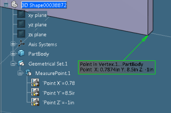

My question regards measuring features inside of a part or assembly 3D file. Is there a way to 'organize' those measurements into individual folders/geometrical sets, like you would do with any other feature/part? I measure hundreds of areas and it becomes very troublesome trying to 'sift' through the measurements..
(I am trying to get some screen shots up to help explain, but am having trouble...current attachment is an example of the types of measurements I take and how it can be difficult to 'Find' the correct one).

Im trying to add a few pictures to my post, but I am having trouble doing so...
Anyways, the attachment in THIS post is how I typically organize my features/parts...I am wondering if there is a way to do something similar with measurements?

in v5 you can use filters and layers... it should help.
in 3DEXPERIENCE measures will be in GeomSet:

...or you can create parameters that measure item using formula. Then move parameters to GoeSet...
