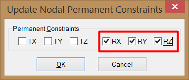

Dear Samurai,
You can remove rotational DOF from solid elements automatically in FEMAP without writing any SPC1 card, neither using PARAM,AUTOMPC,YES: the key is to use commnd "MODIFY > UPDATE OTHER > PERMANENT CONSTRAINTS" > select all nodes from solid elements and next select the DOF you want to remove:
If you PREVIEW your analysis you will see that not any SPC/CPC1 card exist, the DOF removed are part of the GRID card !!.

@Blas - Wow! I'll have to give this a try; it looks like it's exactly what I am looking for. I like the idea of doing the extra research to figure out to get FEMAP to generate a deck exactly the way I want to; this helps to eliminate extra opportunities for errors as I mentioned above.
