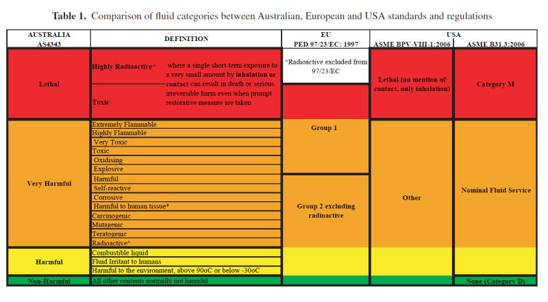

Should it be taken as "lethal fluid" for PV calculation purpose.
Any input will be appreciated.

According to Australian standards AS 4343 "Pressure equipment - Hazard levels":
"Lethal contents are classified as containing a very toxic substance or highly radio active substance which, under the expected concentration and operating conditions, is capable, on leakage, of producing death or serious irreversible harm to persons from a single short term exposure to a very small amount of the substance by inhalation or contact, even when prompt restorative measures are taken.
Very harmful contents are “containing a substance, which, under expected concentration and operating conditions, are classified as extremely or highly flammable, very toxic, toxic, harmful, oxidizing, explosive, self-reactive, corrosive, or harmful to human tissue, but excluding lethal contents.” This class includes carcinogenic, mutagenic and tetatogenic substances.
Harmful contents are “containing a substance which, under the expected concentration and operating conditions, is classified as a combustible liquid or fluid irritant to humans, or is harmful to the environment, above 90
°C, or below –30°C, but excluding lethal or very harmful fluid.
Non-harmful contents are contents not covered by the above categories except for concentration effects such as oxygen depletion and pressure."
See also http://www.designapproval.org/as-4343-i-pressure-e... (the page is in Italian but very easy to navigate through)
