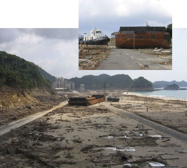

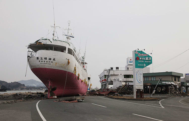

The problem with a fixed shelter or berm is that the height of the tsunami can only be estimated. If it does indeed produce a 100ft wave a fixed shelter may be overtopped. Hence my thinking along the lines of a "lifeboat/ark" type of evacuation.
If you look at some of the photos of large vessels washed ashore by the tsunami it would appear to me that they have a much better survival rate than a fixed structure.
It would appear that none of these large boats were capsized, merely washed ashore.
A large barge like vessel would even fare better in my opinion and be less likely to overturn.

The sample is possibly skewed as any boats that did sink or were capsized would not be seen in these photos.
