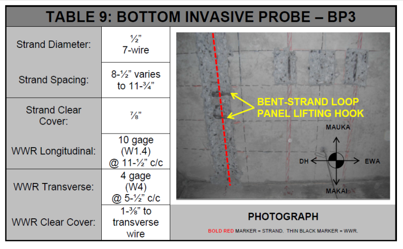

I edit the images before putting them into the Word document. MS Word cannot edit the text as I want it to, or I simply don't know how. I edit the image and add my text in GIMP ( http://www.gimp.org/ ) an open source image manipulation software. I use it to blur areas, add masking, more complicated shapes... most importantly, I use it to put a black or white border around all my text to make it more legible. I hate reading a report with black text on images that make the text difficult to read even under magnification.
The attached image has been shrunk down ~50% so it doesn't mess with the forum layout too much, but here's a recent example. This isn't the BEST example since any solid-colored text would show up decently well, but it shows the outline I describe. It does make a big difference.
So, long story short: I use MS Word for all of it, but I do MOST of my annotation in a proper image editor. I save an "original" version of the image and an "annotated" image in case revision is required.
