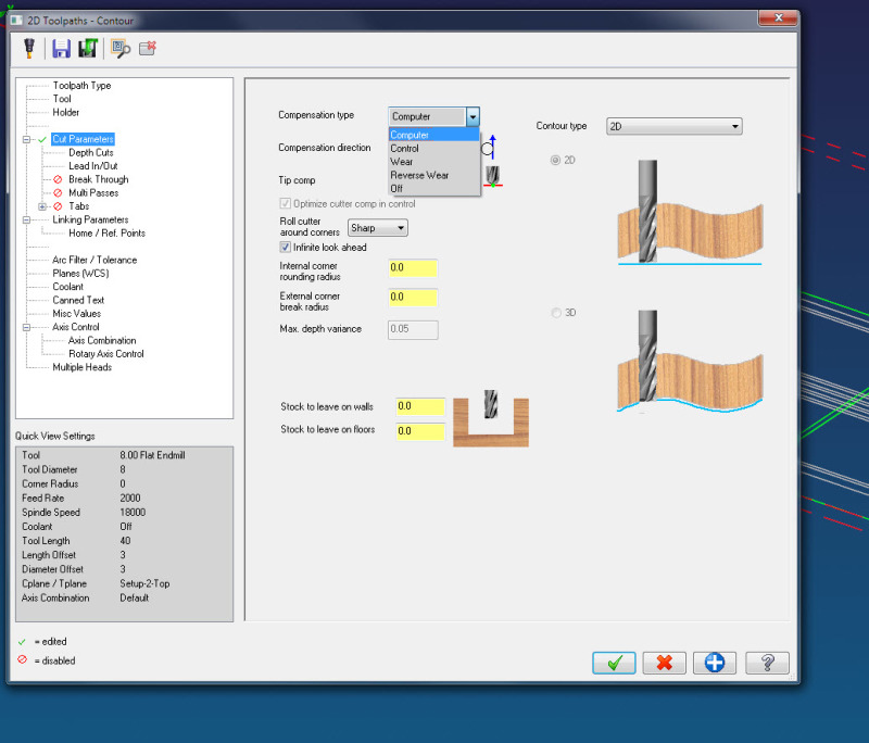

RE: Fanuc Wear Compensation in NX CAM?
Sounds like you were a mastercam user, are you expecting something like this?
Wear in NX is tool tangent, with cutter comp. You can choose left or right for wear or reverse wear
Hi Greg,
Yes I was using Mastercam, where do I make those adjustments in NX?
Many thanks for everybody's help!
John
I'll take some more guesses at translating...
What you call "computer" is the norm in NX. The tool CL is programmed the tool radius away from the part.
What you call "wear" is Cutcom (Cutter Compensation) in NX. The operator can adjust the path left or right of the programmed path.
What you call "contol" is Cutcom with contact/tracking output in NX. The tool contact point (part edge) is output instead of the CL. The operator enters the full radius of the tool to adjust the path away from the part.
If this is right, now you know what to search for in the help :*)
