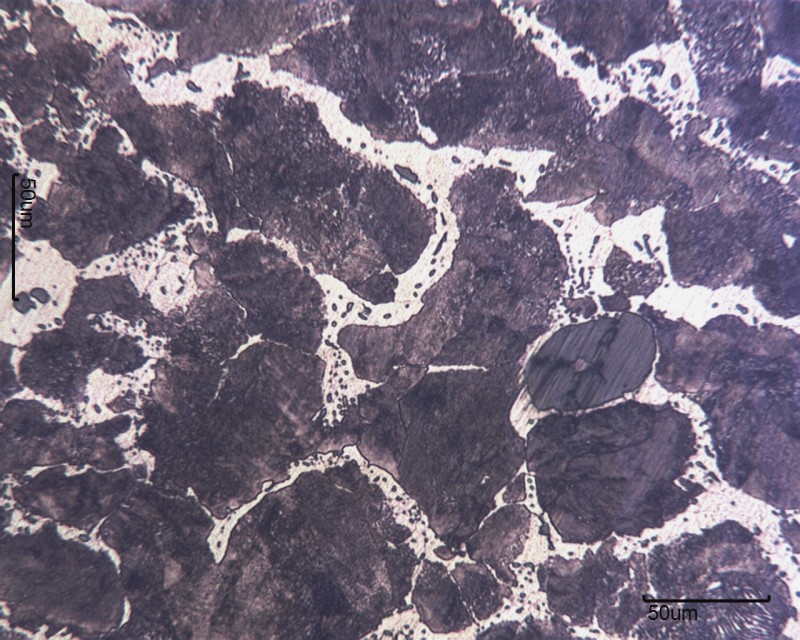

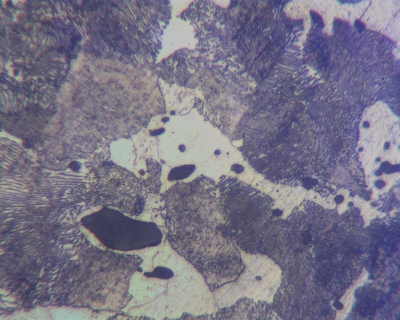

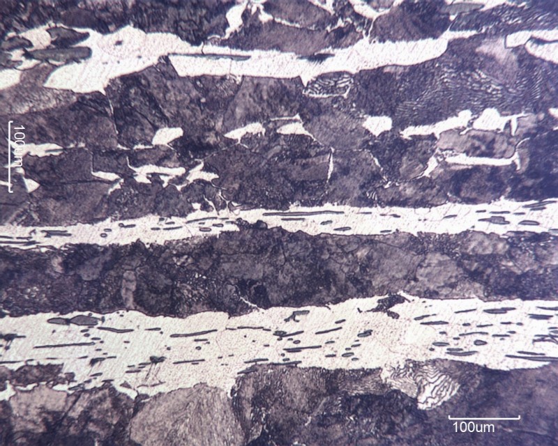

I promised that I was going to post some micrographs so... after having some trouble (I'm taking my first steps on metallography) here they are: Longitudinal and transversal samples, notice the amount of inclusions. It looks to me like ferrite and pearlite, I was expecting to find martensite according to the hardness measured (29HRC average)...... Opinions will be appreciated.
Longitudinal 250X (Dimensional reference is mistaken)
Tranversal 250X
Transversal 1000X
RE: SAE 1144 shaft fracture surface morphology
It looks like virtually no reduction after strand casting.
That is banding!
