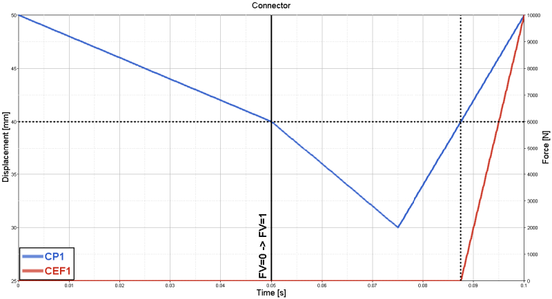

The connectors work well. Now my question is that is it possible to lock only one direction of the connector component? i.e., i am pressing the seat cover which is at 50mm over the seat cushion. once the gap reduces to 40mm the seat cover should be fixed to the seat cushion. However, i just want it to be fixed so that the seat cover cannot move away from the seat cushion but it should be free to move towards the seat cushion.
This is simply like a piston configuration. My upper limit is the lock criteria 40mm. My lower limit is 0mm meaning the seat cover can touch the seat cushion. I dont think i can use connector stop since the initial gap/connector length is 50mm which is more than my required upper limit.
I think this is possible when i activate the connector only when the connector length is less than the upper limit and hence use the stop option. May be using the connector motion which you explained earlier. But unfortunately i am little confused how this connector motion actually works like to activate the connector when the length of the connector reaches a specific value.
Kindly suggest your opinion and provide more clarity on this connector motion or any other options.
Thanks again!
anand
RE: Couple two node/element sets at a later step/ activate connector elements at a later step
Hi Anand,
I agree with all your doubts. *CONNECTOR STOP is not an option in this case.
I think Abaqus does not have simple functionality you are looking for but I have one idea.
The idea is to have two characteristics (one for unlock phase and one for lock phase).
CODE
*CONNECTOR BEHAVIOR, NAME=conn-BEH, EXTRAPOLATION=LINEAR
*CONNECTOR CONSTITUTIVE REFERENCE
 40.0
*CONNECTOR ELASTICITY, COMPONENT=1, NONLINEAR, DEPENDENCIES=1
**     force [N],      disp [mm], , FV1
             0.0,           -1.0, , 0.0
             0.0,            0.0, , 0.0
             0.0,            1.0, , 0.0
             0.0,           -1.0, , 1.0
             0.0,            0.0, , 1.0
          1000.0,            1.0, , 1.0
Next the characteristic is switch from unlock to lock at time you get 40mm of length using field variable.
CODE
*NSET, NSET=field-NSET, ELSET=conn
*AMPLITUDE, NAME=field-AMP
**      time [s],        FV1 [-]
         0.0e-03,            0.0
        50.0e-03,            0.0
        51.0e-03,            1.0
      1000.0e-03,            1.0
*FIELD, VARIABLE=1, AMPLITUDE=field-AMP
 field-NSET, 1.0
Disadvantage of this approach is that you have to know time when you have 40mm a priori.
In my test model initial lengh is 50mm so 40mm of lock condition I have after 10mm of deformation and I assumed it is at time 50ms.
CODE
*AMPLITUDE, NAME=load-AMP
**      time [s],      disp [mm]
         0.0e-03,            0.0
        50.0e-03,          -10.0
        75.0e-03,          -20.0
       100.0e-03,            0.0
*BOUNDARY, TYPE=DISPLACEMENT, AMPLITUDE=load-AMP
 2, 1, 1, 1.0
To do not have this limitation you can use sensor output + UAMP/VUAMP subroutine to control field variable.
Lets take a look for results from my simple model.
Characteristic switch (change value of field variable from 0 to 1) is made at time when I have 40mm for first time.
No force is generated until I got 40mm once again, after this time high resistance force is generated.
I am using boundary conditions so connector deformation is not stopped but it will be for case where connector deformation is controlled by force.
My test model is attached as well.
