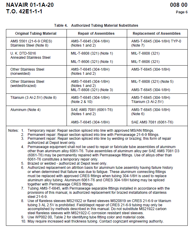

yes, from a material change standpoint this can get complicated depending on the environment (vibration, chemical exposure, temperature, etc.). I have a NAVAIR 01-1A-20 document that suggests this is a common practice. But I would like to see if any other operators or manufactures allow the use of CRES as alternate to aluminum before going further. The NAVAIR document is a generic maintenance manual and is not exactly specific to one acft model.

I took a quick glance thru the NAVAIR Tech manual you noted, and I'm assuming you are referring to sec. 008 00 table 4 shown below. Footnote 4 seems to indicate the aluminum tube itself may be replaced on a temporary basis with AMS-T-6845 cres. But footnote 6 seems to require any permanent repair made with cres tube to also include replacing all connecting fittings with approved cres parts.
There is also the following notation on page 3 of the same section: "NOTE - CRES tubing AMS-T-6845 (304-1/8H) is a suitable substitute for all aluminum alloy tubing when 6061-T6 is unavailable. This does not apply to aluminum alloy low pressure LOX systems. Replacement tubing for low pressure liquid oxygen systems shall be aluminum alloy only."

Tbuelna pretty much found the correct table in USAF T.O. 42E1-1-1 [NAVAIR 01-1-20]... and it authorizes this substitution for fluid systems.

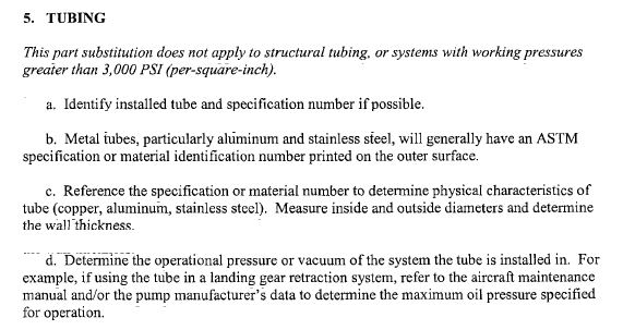

I did a quick review of FAA AC 23-27. Below is the relevant section on tubing material substitutions for hydraulic systems with working pressure <3000psi. Apparently it is considered a "minor alteration" and can be handled with detailed documentation of the substitution in a log book entry.
Hope that helps.
Terry
