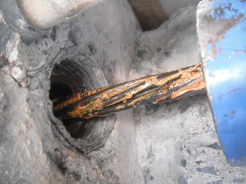

The stressing tails were not cut off and therefore water was able to enter the tendons via the stressing-end anchorages given the 5 year exposure.
Fortunately, the water was not caused corrosion to the strand to date, however, we took grease samples and tested them for water content and they exceed the ACI/PTI specifications for PT coating/grease (0.1% by weight). There is evidence of emulsification of the grease - color change with no translucency, some change in texture, and general thinning of the grease.

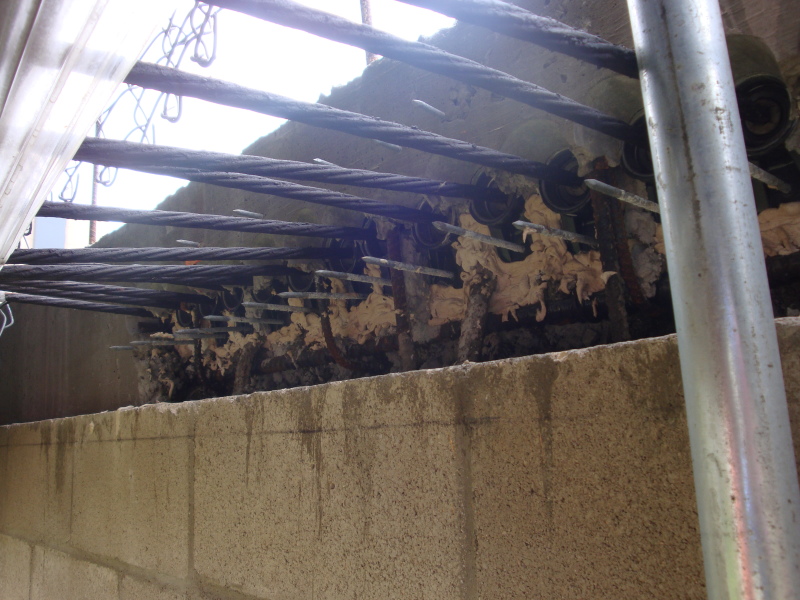

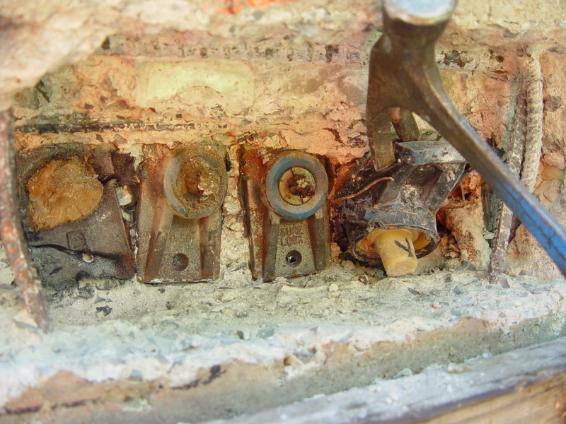

Oh yeah, and voids at stressing-end anchorages...the contractor used HILTI HY-150 epoxy to 'inject' fill the voids and went ahead and stressed the tendons!
...and big voids to fixed-end anchorages:

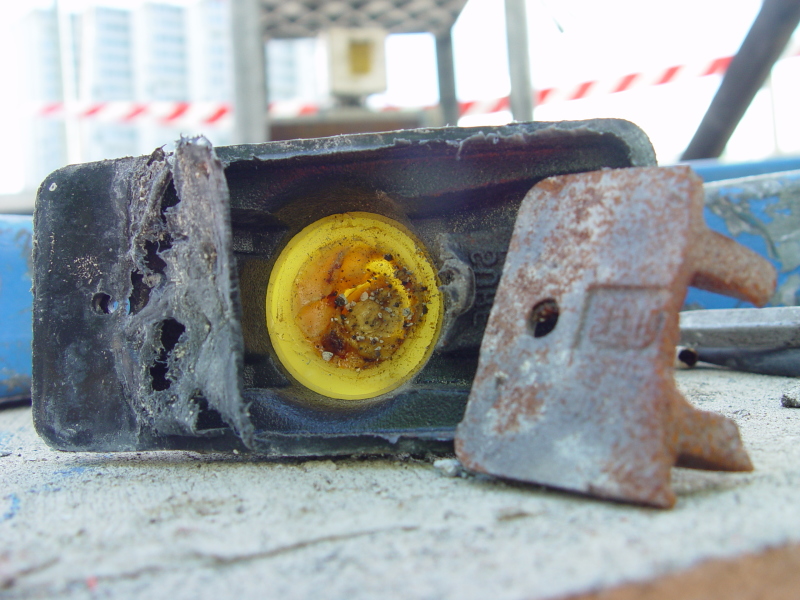

...and fractures to castings due to displacement during stressing because of voids:
