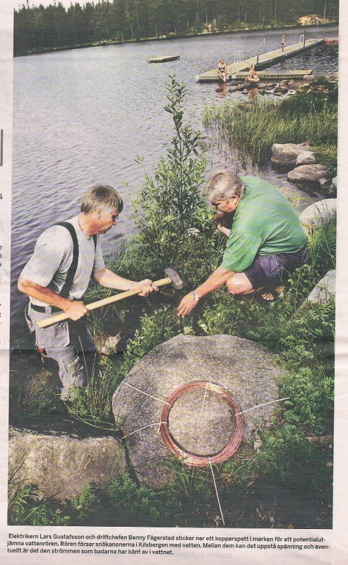

Remember the "Electric Lake" that I was asked to investigate some years ago? I have tried to locate the thread, but can't find it.
Looks like you have got your own version, an Electric Beach...
And, why not? We've already got Electric Clouds - aka Thunder.

Shall we send a couple of electricians to ground the beach? Better safe than sorry - and it will make the Cu-thieves happy.
Gunnar Englund
www.gke.org
RE: Mystery Beach Blast
Is that what they're doing? Is that your "electric lake", Gunnar?
Keith Cress
Right you are, Keith!
They both sheepishly admitted that they were not "quite sure" why they did this.
But the beach guests were happy that someone did something to the problem. Same thing all over the World, I think.
