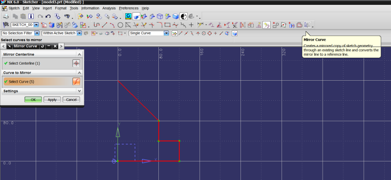

Hi
Do the nx6 sketch mirror function is removed from nx8.5 ?
I want to sketch a half profile and mirror it
Thanks in advanced
RE: nx6 sketch mirror function

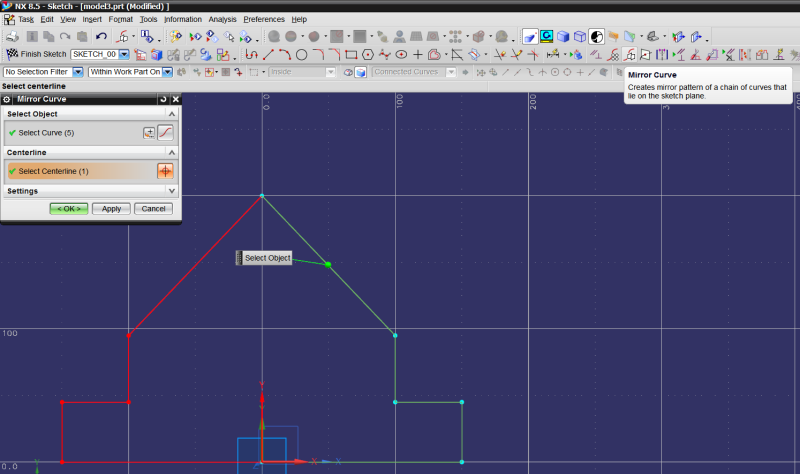

Yes, the Mirror Function is still there albeit under a new updated Icon, as shown below, first NX 6.0 and then NX 8.5:
Also note that the selection order in the dialog has been reversed and that you now can use selection intent, such as 'Connected Curves', 'Tangent Curves' or 'Curves in Group' as well as 'Single Curve', so that it's easier to select a profile with many curve elements. You now select the curves to me mirrored first and then the 'centerline' reference.
