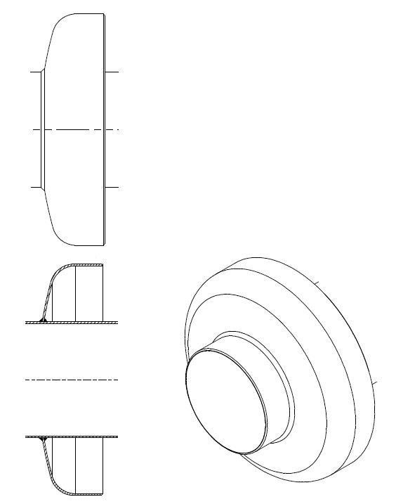

Is this 48 inch cap a part I can buy from a manufacturer, is so from whom? If I have to fabricate, how?
Material would be ASTM A387 Gr 22 or equivalent.
RE: Dumptube Fabrication
dnweld, elliptical heads are widely available: https://www.google.com/?gws_rd=ssl#q=2:1+elliptica...
Cut the center out, weld your cylinder in place.
