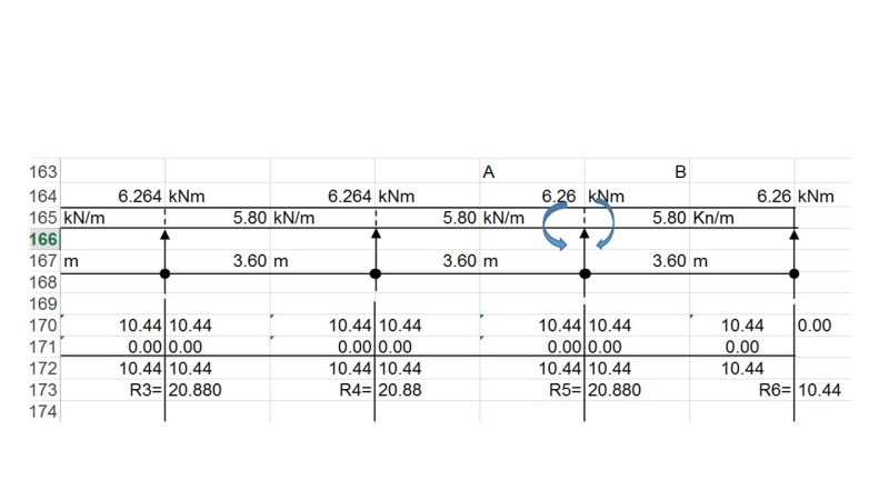

Mr. Jae, thank you so much for that information especially your own way of getting maximum moment with alternating load patterns. As I tried to figure out what you explained, my understanding is that the "moment on interior column" is basically caused by live loads, while dead load moments are cancelled out assuming UDL.
I am only using staad pro to cross-check my spreadsheet for finding moments and reactions on continuous beams and 2D frames. I am going to practice making some simple 3D to see the results.
Attached pic is my spreadsheet I am used to getting moments and reactions. I purposely put two bending moment signs which indicate that the bending moments from Beam A and B at the support (column) cancel out each other. So, my assumption has usually been "no dead load moment transferred to interior supports".
I am more than happy to be corrected on this particular analysis.
Well - sometimes there are dead load moments on interior columns due to differences in spans on either side - if you have uniform bays then the dead load moments would be closer to, or equal to, zero - assuming that all your stiffnesses (beams and columns) are very symmetrical.
