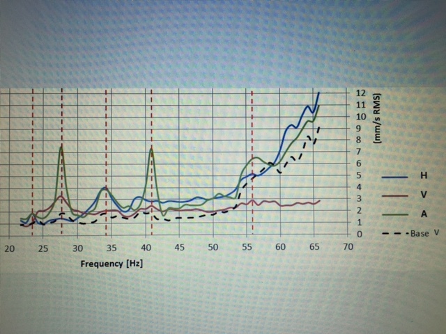

Hello all,
We are trying to troubleshoot a vibration issue with our motor-compressor drivetrain. The issue is that when we run a coast-down from 3600rpm down to the min speed, we get high amplitdue vertical vibrations (7mm/s RMS) at about 1500rpm and 2400rpm. Horizontal and axial vibration levels at these modes are low, less than 4mm/s RMS.
Does anyone have any ides why we may be seeing high amplitudes in one direction only, and what could we do to lower the vertical amplitude down? Thank you!

Let me try to elaborate more.
We are measuring the vibration on the NDE motor foot. We are also measuring the base skid that the drivetrain is attached to, near the NDE. Base skid vibrations are not nearly as high as the motor foot vibrations. This makes me think that isopads are doing their job.
Based on the bump test and modal fea analysis, we can see there are modes aligning with the 1500rpm(25Hz) and 2400rpm(40Hz) and some others but I am mostly interested in these two modes as they exhibit high, vertical only vibrations. Operating range of the motor is 1200rpm (20Hz) to 3600rpm(60Hz).
I don't know if it is even feasible to move these two modes out of the operating range, or if there is anything that can be done to lower the levels.

RE: High vertical vibration amplitude
Hi Greg,
Thanks for your feedback. I would like to invest some time into this problem and do it right and learn something in the process.
I am attaching the plot we took at the NDE motor foot. We have a pretty good match with the bump test results and this coast-down plot. This tells me that my issue is likely to be a structural one. As Walter mentioned it above, I have mass, stiffness and damping to play with but I am not sure what's my next most logical step should be in addressing this. You guys can tell I don't have much experience in applied vibration but I do enjoy problem solving.
Unless I am getting color blind in my old age, it looks like the green trace has two peaks at 7 mm/sec, and that trace is marked Axial! You also stated that machine speed is 3600 rpm (60-Hz), but the data plot extends above 65-Hz! I would like to see pictures and machine component nameplates. What instrument puts the vertical axis label on the right; perhaps plotted with Excel?
Well, this is embarrassing because I mislabeled the axial and vertical plots. The green curve is the vertical (incorrectly labeled as axial on this chart) and the red curve is axial (incorrectly labeled as vertical). Sorry for the confusion.
Also, the Base V plot is the vibration on the base frame, in the vertical direction, near the isolation pads.
You say you changed isolators; did the peaks move in frequency? What are the frequencies of the isolators?
