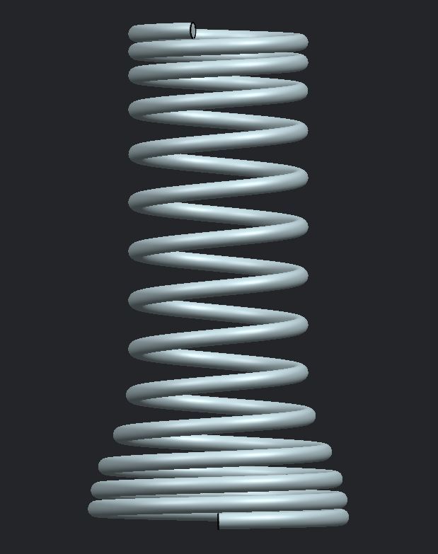

If you could move to something newer than NX 8.0 you could use the new Helix Curve function introduced in NX 8.5, which is much more stable than using Law Curves since you can link its orientation to a Datum CSYS, not just the absolute WCS. And you mentioned that you wanted to control what I assume is that so-called 'end conditions' of the helix, which is also very easy using the new Helix Curve, as shown in this picture of a spring modeled in NX 8.5:
The 'helix' used in this example was created as a single curve using only the interactive, and fully parametric feature-based, options found in the new Helix Curve dialog.
