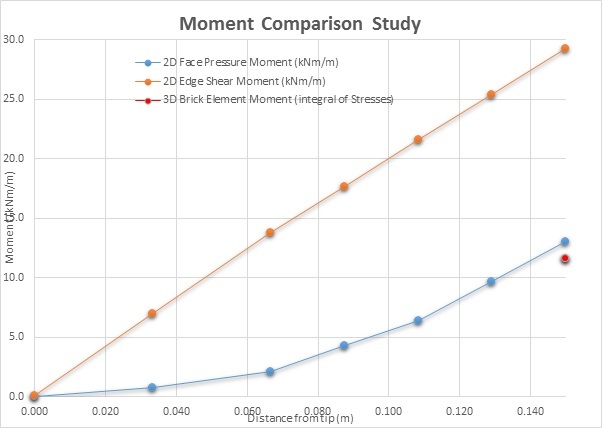

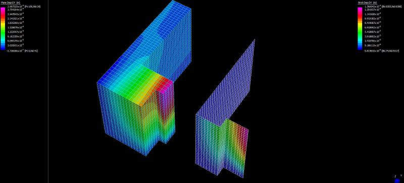

I’ve done a comparison of the deflections and bending moment for 3 situations:
1. Quad 8 plates with a normal face pressure.
2. Quad 8 plates with an “equivalent” normal edge shear stress (this would have clearly lead to more conservative results as a result of a longer lever arm but was done for interest sake).
3. Hex 8 brick elements with a normal face pressure. I had to manually integrate the stresses across the section as the software that I’m using (Strand7) doesn’t have that ability (if I’m wrong, please correct me).
A convergence study was done to determine adequate mesh densities.
Image showing 2D plates and 3D brick elements:
Graphed results:
Conclusions:
1. Although significant material thickness overlap occurs in the 2D plate model, the stress results are very close to that of the brick model.
a. Moment of 13.05kNm (2D) cf. Moment of 11.62kNm (3D). 2D plate is 11% higher.
2. Deflections are significantly different with the 3D model exhibiting a far higher stiffness to that of the 2D model.
a. Deflection of 0.291mm (2D) cf. 0.137mm (3D).
This is by no means meant to be a comprehensive study, but thoughts and comments are most welcome.

RE: Plate Element Thickness Overlap Error
Personally I wouldn't read anything into the comparison as the geometry is plainly unsuitable for shell elements. I don't understand the representation of the 3D model by shell elements, that you've used. It could be that the shell parts are too long and as such are less stiff to give higher deflections. The agreement with stresses may just be coincidental.
Your points are noted and in addition, after some thought, having a single result that correlates doesn't give me the confidence to move forward on the 2D plate basis.
Having said that, I do believe that the probability of the results being so close considering the use of different formulation, different geometry, and manual integration of the stress block compared to straight forward output, is extremely low.
Thanks for the input.
