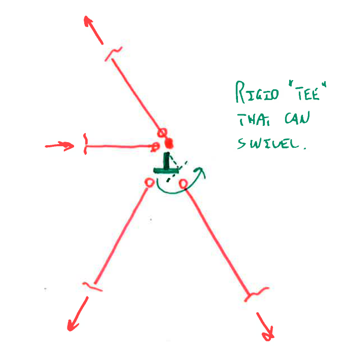

My concern was actually that, we're using two ropes to pick up the tube at 4 places as you can see in the picture - the red are the actual ropes that will be used - but we're modeling the ropes as four separate elements and so I wasn't sure if we could trust this to determine the lengths of all the ropes/spreader bar. The tension in the bottom four ropes will be the same in real life so I wasn't sure if adjusting the geometry to make this happen in the model would be accurate.

That is an interesting problem. Short of getting fancy with Abaqus or Adina, I'm not sure how one would best model the situation. Below, I've proposed a rigid swivel thing that might capture the fundamental aspects of the behavior. I haven't tried this myself so take it with a grain of salt.

Hm so with that Tee, we'd want to make it remain in that position to ensure equal loading?
Quite the opposite. The tee would need to rotate to simulate the cable sliding over a pulley of sorts.
Ah yes, I was thinking I would let it rotate, but then try to get it not to - but that's not it because although the forces in the cables should be equal, they're at different angles so the T will rotate. Right?
My thinking was that the cable will start off being of equal length on each side of the joint but, due to deflection of the HSS some of the cable will slide over the joint to the outside. My hope was that the TEE rotation could capture some of that. Like I said, though, it's just an idea. I'm not sure that it will produce the desired results.
