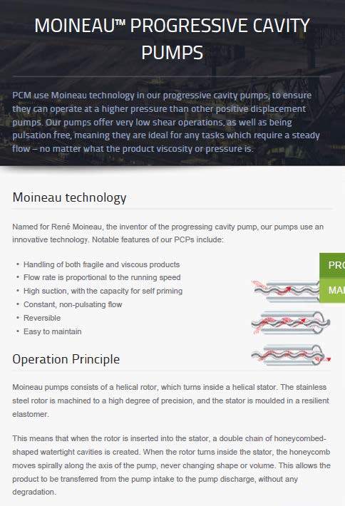

The inventor of the pump was named René Moineau. The firm that he founded, PCM uses the words progressing and progressive interchangeably to describe this pump. There is no reason to be pretentious.
