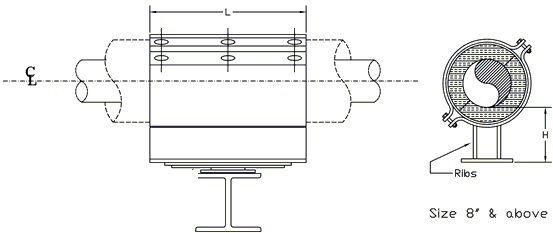

The supports are as the image below.
RE: Pipe Clamp Slippage on Cold Insulated Line
The available clamping force is very low. Hence your support needs to be double or more what you have now.
I don't see the bar you mention and the detail at the support foot looks odd– too short?

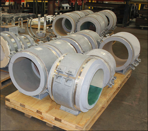

It appears that the diameter of the clamp is too large, not allowing enough clamping force. Replace the clamp with a proper size clamp. See the picture:
Information is available on this site:
http://www.pipingtech.com/blog/tag/cold-shoes/

@Littleinch, the rod is welded on top of steel plate of sleepers. A few supports are on structure as shown below. Similar is location of rod for sleeper supports.
The rod is part of your problem. Assuming it starts in the centre of the support, as soon as it moves, the support becomes loaded differently one end from the other.
Normally this is negligible, but with such a weak material to clamp on, my guess is that the supports become tilted ever so slightly. Thus when the pipe tries to sllde back, there is more resistance and hence the clamp will tend to slowly jack itself along the pipe.
I would remove the rod and insert a Teflon pad to allow the clamp to slide on the support with less force / friction. You might need to re-do the stress analysis as the analysis will have assumed a certain level of friction / force at each support based on the current design (metal to metal)

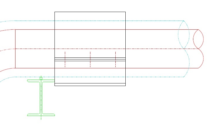

I'm going to presume that the first CAD "supports" drawing is an example of a drawing representing not what is installed (multiple "plates" of some sort between underside of pipe shoe and top of support and evidently no round bar/rod shown).
Why is there a round bar/rod attached to the top of the support, does anyone know?
Why is this called a "sleeper" in the OP first post? A sleeper is often a grade-floating concrete beam used to support pipes in a tank farm area (and, yes, they often have steel pipe embedded in them so that suppported piping does not sit on a concrete surface).

@Gator, please read my post at 10:55. The sketch shown is for structure as it is at a few points. All remaining are on sleepers "as you described".
