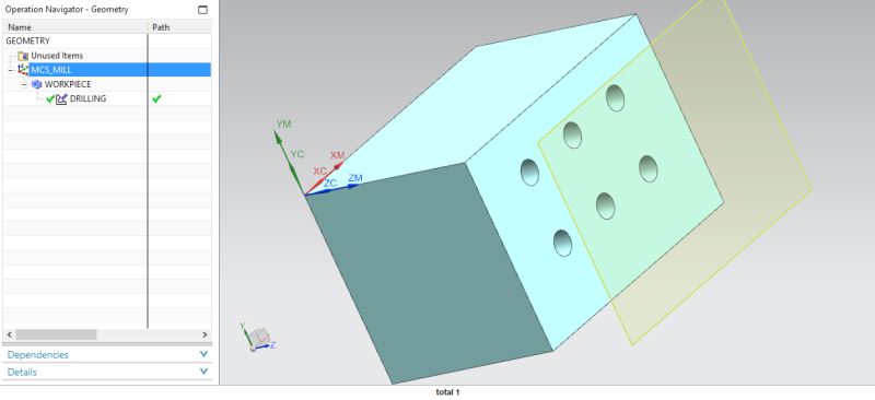

Hi, everyone,

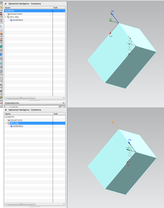

Felt a bit confused about how to set the coordinates for "Geometry" view.
In the "Geometry" view, the origin of the MCS is on the top of the part.
In the "MCS_Mill", origin in on the bottom of the part.
I wonder if I can change the MCS to the bottom for the "Geometry" view.
Details are shown in the pics.
Thanks for helping

If you select the root (top) node in the geometry view, you will see the absolute coordinate system, since there is no MCS defined at that level. This is expected, and not a problem, because operations should always be under an MCS group, which determines their output coordinates.
For a little experiment, create several MCS groups at different locations or orientations. Now create a simple milling operation and generate the path. Now drag it under each group, and the root node, and list it at each location. You will see different coordinates, even though the path has not been regenerated.

I'm confused trying to understand this, so let's try some CSYS review so can communicate with the same terminology.
There is one absolute CSYS. It cannot be moved. It is not displayed. It can be used as a reference (e.g. you can define a datum CSYS at absolute).
Datum CSYS and CSYS are entities that can be saved and referenced.
XC YC ZC is the WCS = Work Coordinate System, used for user input in NX. There is only one WCS at any time. Move it anywhere, or select a saved CSYS. It is not used for any CAM output.
XM YM ZM is the MCS = Machinine Coordinate System, used for CAM output. You can define as many as you want. The one used for ouput is based on where the operation is in the Geometry View of the Operation Navigator.
MCS can have options for its useage. For example you may have one main MCS for the origin, and several others for fixture offsets.

Problem solved. The key is to define the origin of abs coordinate on the top of the workpiece in simulation(same as the WCS of the "Geometry" view).
No matter how I set MCS, WCS, reference, it didn't matter. Although the outputs are different...
Weird results and thanks for helping

I understand exactly what you're talking about and I agree the behavior is a bit unexpected. At least in Program view. It goes back to absolute but that's really not where your mcs is set. If you select an existing operation you will see that it is set where you created the mcs and if you create new operations with that mcs they will display properly.
I understand what Mark is saying but I still feel that behavior is somewhat unexpected since the mcs is "specified" but it can display differently. That seems inconsistent to me but oh well.
