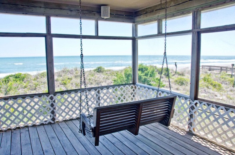

Quote (ABC News)
Preliminary findings reveal the floor joists and fasteners failed to hold the deck together, Emerald Island Town Manager Frank Rush told ABC News today. Results from the investigation could be released as early as Monday, he said.
http://abcnews.go.com/US/inspectors-investigating-...
Looks like the floor joists and deck all came down together:

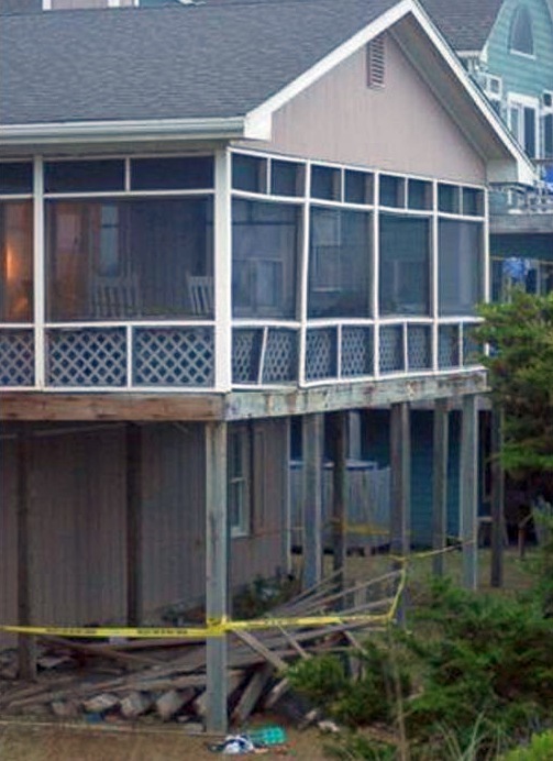

RE: Deck Collapse in North Carolina
I'm guessing that the joists were sitting on small ledgers which were in turn nailed to the beams. When the nails corroded away or failed in end grain tension, the beam moved laterally to the outside, and the joists just fell off.
Hokie - Right you are about the ledgers:
Hot dipped galvanized nails in this salt air / spray environment typically corrode at the junction of the wood members. They will "neck down" at this spot to almost nothing as years go by. Emerald Isle is on the lower end of the Outer Banks, the land is an isthmus only a couple of blocks wide, from the Atlantic Ocean to the (salt water) Bogue Sound. That part of North Carolina gets many close calls from hurricanes and other storms - a constant barrage of salt spray from all sides.

That deck does not look like it has had an ounce of maintenance in years.
This appears to the the best picture I've seen: https://lintvksnw.files.wordpress.com/2015/07/58ff... Nails appear on the right side beam, but not the left.

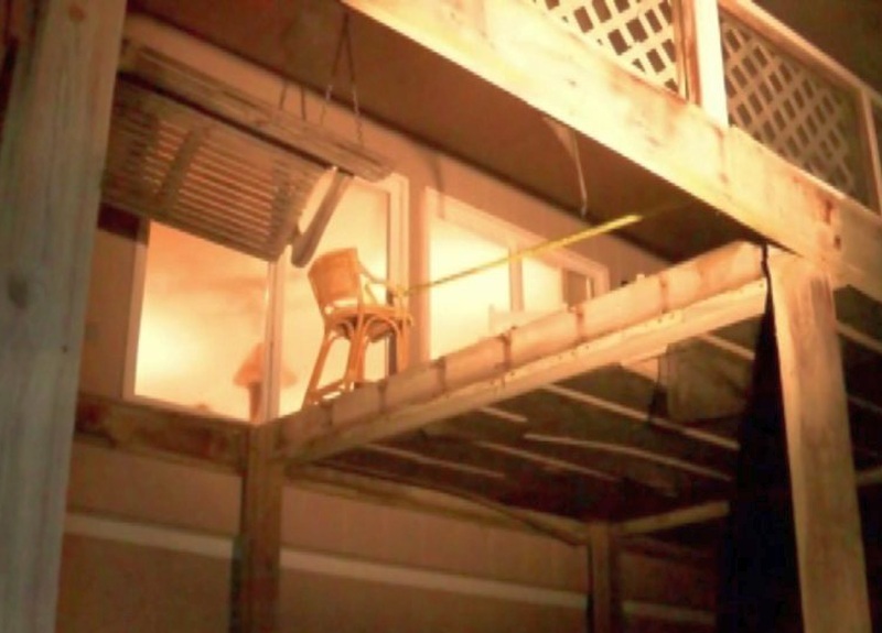

Hokie - I believe the left ledger is gone. Take a look at the enlargement of IRstuff's photo below.
I propose all the corroded nail on the left side sheared (the nails into the ends of the joist and the nails holding the ledger in place).
As the left side of the floor descended the joists rotated downward... pulling away from nails remaining in place on the right.
This explains why no full length nails are visible on the left side, yet the right ledger and full length nails are visible on the right.
The photo JAE furnished, showing nail holes, must be of the right end of the joists.
Here is the enlargement of the left side:
Much better photos!
Looks like the left ledger dropped and allowed rotation that pulled the right side of the joists out from the beam.
The ledgers were installed on the bottom of a double beam, with all the fasteners in tension (however few of them there were). Ledger fasteners should be in shear, not tension. Even if the fasteners did not corrode, it would be easier to overload the pullout in this orientation.
I didn't get that, Ron. Looks like to me the ledgers were about 2"x2", nailed to the side of the beams. The one on the right side which was still in place seemed to have nails horizontal.
Ron - From everything that I have seen, read, and know (first hand: 50 years+) about SC, NC beach house construction, here's my take on it:
Double 2 x 10 beams, approximately 10' long.
2 x 8 floor joists @ 16" O.C, each approximately 12' long.
2 x 2 ledger with 3 nails under each joist (probably 16d or 20c common). Nails loaded in shear.
Remains of toenails from joists into beams (probably 12d or 16d common).

SRE...that's what I would have expected as well except that the right side looks like a solid piece of lumber under the double 2x10's. I see the 3 nails under each joist, as you would expect, but it looks strange. Maybe I'm just not seeing it correctly from the angle or resolution.
I think you'd have to be nuts to construct it as I described above, but considering the amount of bad construction I've investigated over the last 35 years, not much surprises me anymore.
Looking at the band below the sliding glass doors, the left side looks like maybe a 2x12 and the right side narrower and is pieced with a 2x2. Why? That member picks up essentially no load.
Ron, I think it is a visual illusion - the 2x2 shadow is farther down the wall, indicating it is protruding farther from the wall than the 2x12. There seems like some anti-pest netting underneath and maybe the little strip was part of that.
The ledger looks like a 2x8 laid flat against the bottom of the beam. It looks like the ledger is toenailed to the beam since no fasteners are visible in the bottom face of the ledger.

I vacation at the beach in NC once a year. A couple years ago a deck collapsed at Ocean Isle beach (not far from this one). The environment out there is harsh. You should see people's outside air handlers. They, and really everything that is outside gets corroded quickly. I remember that the zipper on a bocce ball set that was stored inside, albeit not in a conditioned space was corroded. I don't know the solution for this type of environment other than providing a mechanism of failure that is visually evident prior to failure. I think Simpson hanger connections (top flange ones) would be a better solution. Maybe even coat the fastener's with a better coating than the hanger. That way when you see the hanger corroding you know it's time to do something. Because you won't see the fasteners fail, but you might see excessive corrosion on a hanger.
Honestly, I don't know how you engineer this. I think this is like the folks that have a water heater in their attic. You replace it every 10 years whether you need to or not, because you sure don't want to wait for it to break. Problem is that most all of the houses in the worst environments in these areas are rental properties where the owner wants to do as little as possible in maintenance, and I can't blame them for that.

Looking at the pictures I don't see how anyone can determine what was galv was used (if any). In the 1980s Hot dip Galv was not always used on coastal decks.
Loading 24-26 people on the 1/3 western corner of a 8'6x10' deck overloads the structure (I believe the SBC used 40 PSF in the 1980s)

Isn't that black stain in the wood at the fasteners caused by leaching/oxidation of the zinc coating?

Charlie, looked like they were rusted away in the ledger
