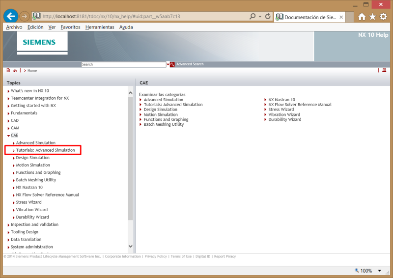

For tutorials click in HELP > CAE > TUTORIALS: ADVANCED SIMULATION
