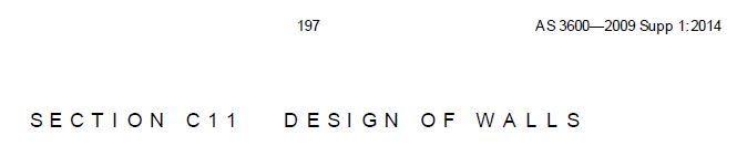

Peter, there is now a commentary to our current 2009 code that was released in 2014.
RE: AS3600 shear wall design
I look before I replied on the SAA site there is nothing
The Commentary is listed on the SAI Global web site,although it is below a superseded version for some reason.
Yes, thanks all I have found it now, as you say Doug it is out of chronological sequence.

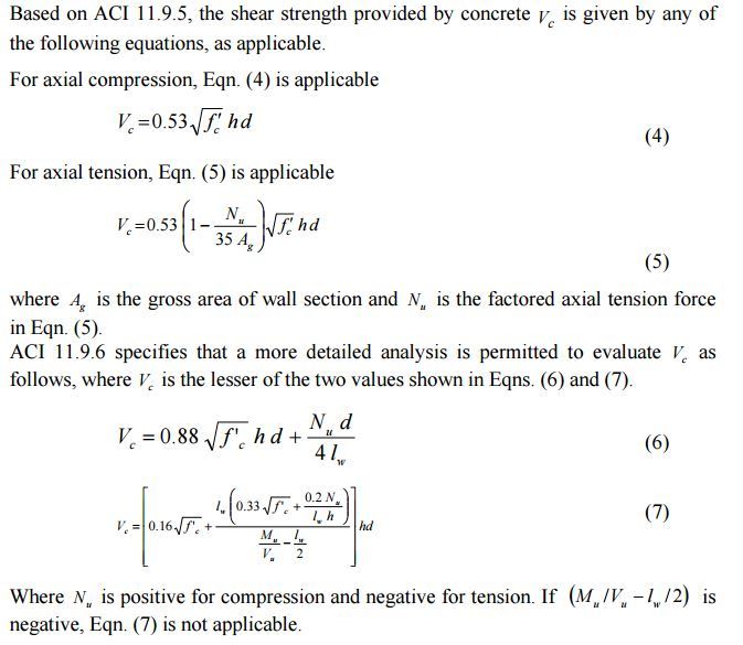

Peter, in regards to item b)
Trenno,
I am aware of other code provisions. My point was that AS3600 has none.
Certifying engineers will not accept ACI code in Australia.
Sorry, no worries.
I thought we could cite something along the lines of "engineering judgement and best practice," which is allowed in the BCA?
