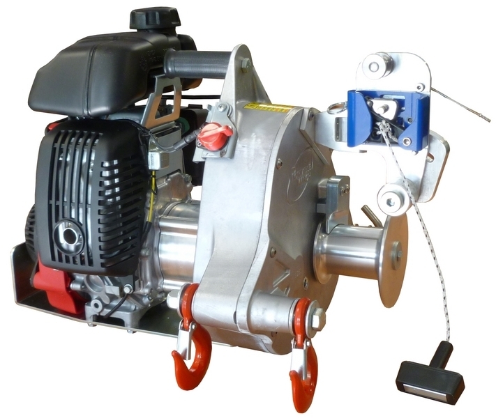

Thank you everyone for your feedback, please keep suggestions coming, it's much appreciated!
Naturally, I'm trying to keep my costs down and final set-up as close to KISS principle safe to do.
Ideally, I'd like to find a more powerful version of this inexpensive portable capstan unit here...
http://portablewinch.com/en/products/PCH1000.html
Unfortunately, at only 2.1 hp, it is only rated for...
Max. pulling force 775 kg (1700 lb)
Rated lifting cap 250 kg (550 lb)
I'm still looking for larger gas powered capstan unit, but so far am only seeing a few out of Australia
that are mid-sized larger and not way too big overkill and expensive. I'm thinking that a drum winch,
big enough to hold 2,000' ft of cable would be even more expensive, but am willing to re-look at that.

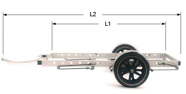

Best maybe to endure more trips by dropping the combined trailer weight and maximum required load to under 700 lbs by using this...
http://www.bikesatwork.com/bike-trailers/specifica...
It's toughest configuration is rated for handling maximum 600 lbs of cargo and that particular trailer itself weighs just 70 lbs.
If we went that route, do you see any reason why that capstan winch above, the http://portablewinch.com/en/products/PCH1000.html
rated at Max. pulling force 775 kg (1700 lb) and Rated lifting cap 250 kg (550 lb) couldn't readily handle worst 45 degree incline?
I'd just have to figure out a skid plate for it for whenever the tongue was on the ground. The tires can be placed more forward or
back and loads situated so that we could strive to keep tongue from excessively scraping. That'll take some experimentation. Also,
lowering it straight back down hill will probably be a challenge, but most any trailer we'd use probably would be, too.
What do you think?
- Shane

Thank you for comments, they've helped me zero in on something more practical, as described in my last post above.
Smaller, cheaper set-up carrying much smaller maximum loads more frequently.
I'd only add that I'm looking at Samson Stable Braid in 1/2” diameter, it's a double-braid, 100% polyester rigging
rope with "exceptionally low stretch" they say, and a breaking strength of 10,400 lbs. It's been used and praised
by other owners of same capstan winch specified above.
That reduced load and requirements on winch and rope and reduced cost of all components is attractive, if it'll
both work and with sufficient safety margin. My intention at this point is, with capstan winch anchored atop, I'd
draw up the cart. An available option, for little additional $, I'd likely do, too, is to get second set axle/tires
so it's much less of an unstable rickshaw. And, while getting rig back down hill can be done in a very slow speed
controlled manner, steering could likely be an issue requiring trial & error experimenting with it.
As described in post #7 above, along with what I've also shared here, does this set-up start to look like it oughta
do thejob and with a sufficient safety margin?
- Shane
