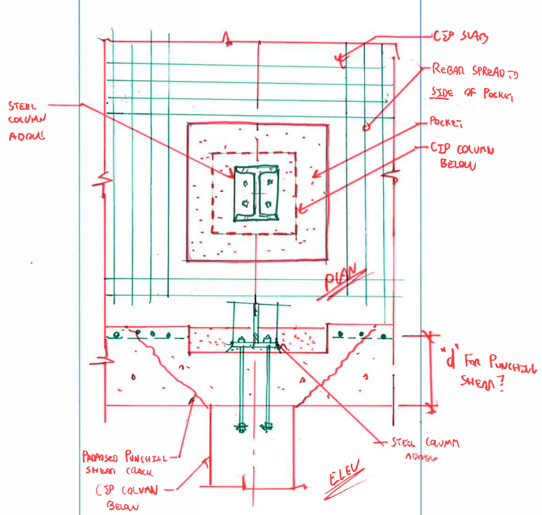

I'm getting pushed pretty hard to use the detail below. The reason is pretty straight forward: compared to a column welded to a cast in plate, plumbing and erection is much easier with this detail. It definitely can be done with the welded detail however.
The photo at the bottom was taken from a related thread on this forum and shows a steel column that is supported directly above a concrete column below. While a consensus has not been reached there, my opinion is that a similar, recessed pocket detail is to blame for the cracking shown.
There are other details that I could use here but that's not what I'm seeking. What I'd like to get feedback on is a method for evaluating whether or not the detail shown below works. What needs to be checked here in order to give this a passing grade?
My specific concerns and opinions are as follows:
1) The recess forces one to either drop the top reinforcing mat or push the bars out to the side of the pocket.
2) With the mat dropped, punching shear is a beast and significant cracking can be expected as shown in the photo.
3) With the top steel moved to the side of the recess, it's tough to meet the code rules on the amount of steel that may be placed over and near the column.
4) With the top steel moved to the side of the recess, I again wonder about punching shear capacity. See the hypothetical cracks in my sketch below. My concern is exacerbated by the interrelated nature of punching shear and flexural capacity (Link) at column/slab joints. If I shift my moment capacity away from the column, does that mess with my punching shear capacity?
5) I have renovated buildings from the 70's and 80's that had similar details but with drop panels. They seemed to be performing well.

Can you shrink the pocket so that it fits tighter around the column? What about if you had sloped sides of the pocket?

I wouldn't feel comfortable with this detail at all. I would either look into using shear head reinforcement, a column capitol, or a drop panel.

I would have a drop panel of atleast the depth of the pocket, and treat it as a slab fold with lapped Z bars. The detail drawn thrashes both your moment and shear capacity of the slab at the column which is exactly where you need it I would think ponder

I'm afraid that I'm not in a position to elaborate very much David. They were both main floor slabs at the base of fairly tall steel buildings. The columns were enormous which was probably helpful. The top steel in the slab was called out in the usual way. Unfortunately, the detail showing the column bearing pocket did not show rebar. As such, I don't know the disposition of the rebar.

RE: Steel Column Connection to Concrete Slab - Recessed Pocket
I very much agree that:
1) the proposed detail is questionable and;
2) there are several ways to make improvements (drop panels, shear heads, etc.)
What I'm really gunning for here, however, is a method of evaluating the proposed detail. When someone proposes a cost savings measure, I hate to veto it based on gut feel alone. I do it, from time to time, but I much prefer to have a quantifiable basis for rejection.
I'll ask some more targeted questions and see if that gets me any closer to what I seek. Consider the condition sketched below and the following related questions:
1) Is it valid to calculate punching shear based on the critical section and slab depth that I've proposed below?
2) Given the choice between pushing the top steel to the side of the pocket and dropping the mat below the pocket, which is best? I'll probably do a bit of both.
3) If I am unable to pack the top steel into the 1.5D zone either size of the column, what can I expect the physical implications to be? Severe cracking? Punching shear failure?
4) If I am unable to pack the top steel into the 1.5D zone either size of the column, does that represent an unforgivable code violation? How beholden are we to that clause?

OK, here goes:
1) I would think not, but don't think there has been any testing on that type arrangement, so I don't believe the code provisions apply.
2) You need the depth for flexural capacity.
3) The Australian Standard is a bit different, requiring 25% of negative capacity within the column plus D each side, but I think the main problem with the recess is that, like all recesses, stress risers will develop from the corners. When these cracks form in an already highly stressed area, the unpredictable may happen.
4) I would consider the provision almost inviolate, but all bets are off with the recess.

I was curious about this so I did a quick 3d linear analysis of an example slab with and without the 500x500x100 recess. I assumed the following:
1. F'c = 30MPa
2. Interior slab region modeled. span = 8.0m
3. ft = 2.5MPa (assumed a lower value of concrete tensile strength to amplify cracking)
4. dead load = self
5. Live load = 4.8kPa
6. Simple tensile material model used for concrete effects in tension
7. 15M at 12" o/c top and bottom. I should have spent a bit more time detailing something more appropriate
I am a little hesitant to post, but I will anyway. I have not spent a great amount of time pondering the model. Anyway, here are a few plots in case you are interested.

Thanks so much for the FEM Brad! I regret that I have but one star to give.
I'm actually going to take the printouts into a meeting with me this morning. One can clearly see the stress concentrations that Hokie mentioned as well as the concrete trying to form compression struts around the pocket consistent with my assumptions regarding the punching shear perimeter (which is not to say that the capacity checks out of course).

I should come clean and confess that the 100 mm recess depth was my idea. I thought that would be the minimum to hide the nuts, base plate, and grout and avoid finishing difficulties. If I can use one of those inserts to reduce the recess depth, I certainly will.
Heh - sort of like a voice inside you saying "Use the Force, KootK, use the Force. Close your eyes and trust your gut."
