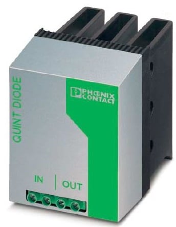

or you can buy a DIN rail mount 'isolator' with heat sinks ans wiring terminals:
