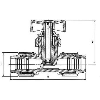

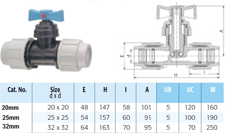

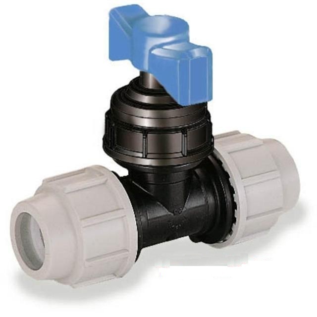

The tap looks like this one:

Is the valve a quarter turn valve or a screw action much like a normal sink tap or stop cock?
Even a quarter turn ball valve will often have a reduced bore for a plastic valve.
At those sorts of pressures and flows I suspect that is where a lot of your extra unaccounted losses are coming from.
RE: Quick check please!
I feel stupid now - I could have looked up that cross section myself couldn't I? Thank you for pointing out the obvious. It is indeed one of these types rather than a quarter turn.
Looking at the section it is clearly nowhere near full bore when open.
I can use my measured results to calculate the loss coefficient for it.

Some of the metal stop cocks are gate valves, some are like this. If you want more flow swap out the valve for one with a smoother flow path.
