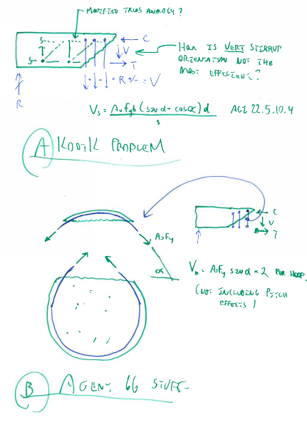

Tomfh & hokie66, the point is that for a typical 45 degree shear crack/plane, not all bars in a circular member intersect the crack at 90 degrees (think of the bar crossing the 45 degree shear plane anywhere but the center of the member), this leads to a reduction in the 'efficiency' of the spiral when compared with typical ties in a rectangular member. In a rectangular member the bars cross the shear plane at 90 degrees, in a circular member this angle varies depending on where you take your slice through the section. Most codes including ACI have provisions for ties which are placed at some other angle than being vertical in a beam, they are not as effective if you tilt a stirrup over, its similar in concept to this and is the "correct" formulation.

Yeah that's what I was referring to if it wasn't clear. I was almost forced to draw a picture.... smile

Think in terms of the strength developed across any 45 degree crack as being governed by the 'shorter' portion of circular bar on the other side of the crack (the smaller semicircular part) and the angle it makes in plan with the crack line across the section. Realising this you can't have more capacity from the other half of the spiral simply because it has better anchorage. The force you can develop perpendicular to the direction of loading depends on the angle the bar crosses the shear plane. This is different for all bars crossing the shear plane.
So it's not a matter of taking the full strength of each bar, some are simply less efficient.

Can you explain to me why inclined stirrups would be more efficient in a post-cracked state where the principle stresses have already dissipated due to cracking? See my sketch "A" below. Conceived of in typical modified truss fashion, I would certainly expect vertical ties to be the most efficient. Help!
Sketch "B" below illustrates my understanding of the phenomenon that Agent666, has been describing.

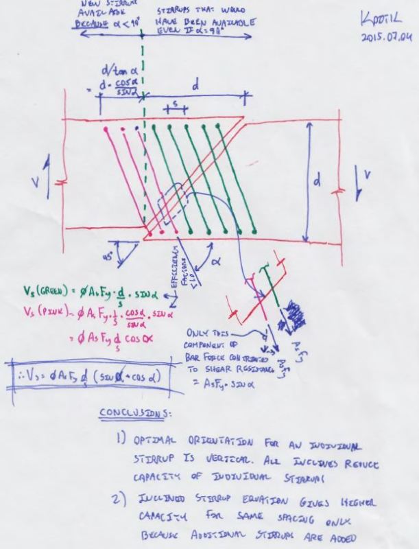

RE: Shear ties compared to spiral reinforcement
Quote (KootK)
Placing the stirrups at an inclined angle simply makes the concrete strut intersect more stirrups. This means 'Av' in your equation increases (or 's' decreases, whichever way you want to look at it). Assuming a concrete strut at 45 degrees, placing stirrups at 45 degrees perpendicular to the strut would be the most efficient and increase your 'Vs' by sqrt(2). It is easier to visualize if you do the opposite and consider inclining the stirrups the other way to be parallel to the strut; this would obviously reduce your strut efficiency to 0.
To clarify, when I say 'placing stirrups at 45 degrees perpendicular to the strut', I mean the stirrups and strut are perpendicular, with the strut being at 45deg from vertical and the stirrups being 45deg from the vertical the other direction.

@Hokie:
Using nonplussed's guidance, I've attempted my own derivation of the ACI inclined stirrups equation (below and attached). No doubt I could have just found it in a textbook if I had the right one. Anyhow, here are the conclusions that I've drawn from the derivation:
1) The sin term may be thought of as representing the stirrups that would have been available even if there were no incline. The capacity of those stirrups is multiplied by the sine of the incline angle to reduce their effectiveness.
2) The cos term may be thought of as representing the extra stirrups that cross the shear crack as a result of the incline. The capacity of these stirrups, too, are multiplied by the sine of the incline angle to reduce their effectiveness. This multiplication cancels out in the mathematics of determining the extra tie area available however.
3) The ACI equation for inclined stirrups shows an increase in capacity relative to perpendicular stirrups only because more stirrups become involved, not because individual stirrups are more effective when oriented more perpendicular to the anticipated angle of the shear crack.
4) The derivation of the ACI inclined stirrup equation suggests that the optimal orientation for stirrups is perpendicular to the longitudinal axis of the member. All other orientations, including perpendicular to the shear crack, are inferior and and that inefficiency is quantified by multiplying capacity by the sine of the angle that the stirrups make with the direction of the applied shear.
