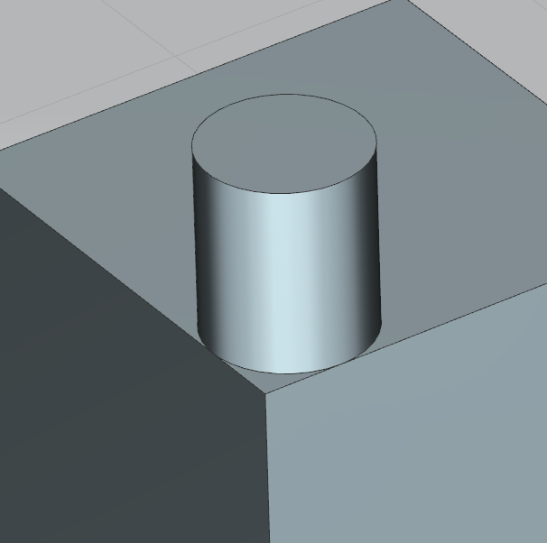

Technically Parasolid can support non-manifold models it's just that when we designed UG/NX based around Parasolid that we chose to use an option that disallows this. Now this was done prior to the SDRC/Ideas acquisition when our primary goal was to only create models which could be physically realized, as in machining them. By definition, non-manifold models can not be manufactured. Now NX does allow some topological conditions which are technically non-manifold, but these are generally limited to certain face tangent conditions like this one:
As for the need to create models for analysis where non-manifold conditions might be needed, this is being accomplished during the creation of the FEM models and does not require that the actual solid model be created non-manifold just that the analysis model can be.
