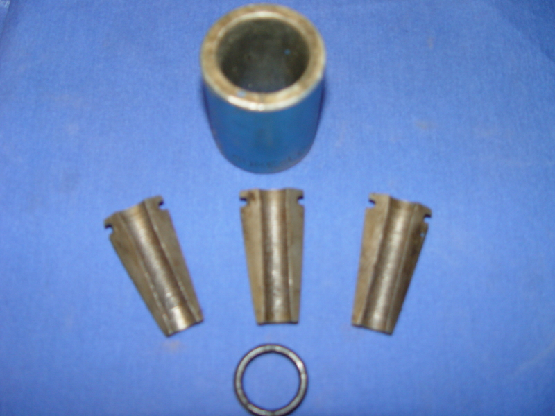

Steel is typically 7-wire strand and gripped with re-useable barrel chucks that commonly use a 3-piece wedge. Precision-Surelock is a US based manufacturer of such components.

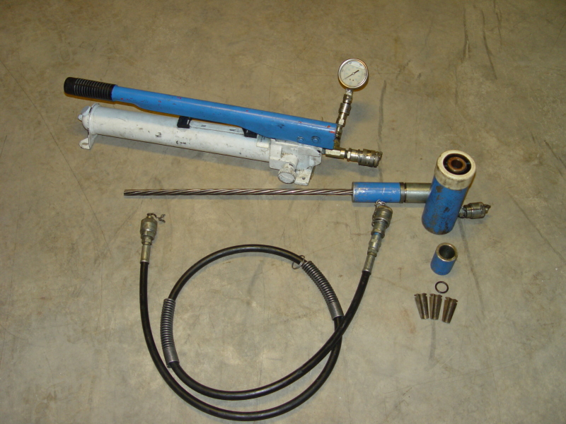

2. Since this is a spring-return ram (one-way acting) you only need to purchase a single hydrailic hose - purchase a Enerpac one knowing it will be rated to bursting pressure for a max of 10,000 psi.

4. For common 1/2" dia 7-wire strand, the stressing jack would use multi-use chucks like these: Link and the strand is inserted into the hollow centre of the ram and the chuck installed over the strand at the back of the ram. Use grease on the wedge to chuck barrel interface to make it easier to 'break-out' (remove) the wedges after stressing.

3. The following photo is of the components that make up a small stressing set-up:

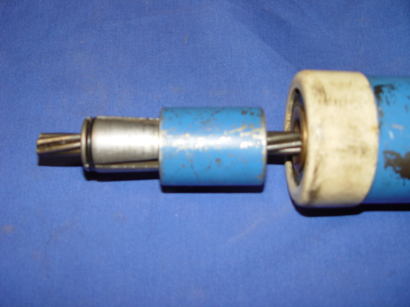

4. The following photo is how a multi-use chuck would grip a 7-wire strand on the back of a hollow centre ram:
You will need 2 multi-use chucks for each prestressing wire - one for each end. You will pre-cut your prestressing wire with one end say 2 or 3 feet longer for purposes of stressing each wire, so you need one additional multi-use chuck for stressing...BUT, stressing with a hollow centre ram you are going to require a 'nose' with a recess on the leading edge so that when you stress the wire chuck wedges can displace a small distance - if the wedges cannot 'slip' freely during stressing then you will not correctly stress the wire/s.
