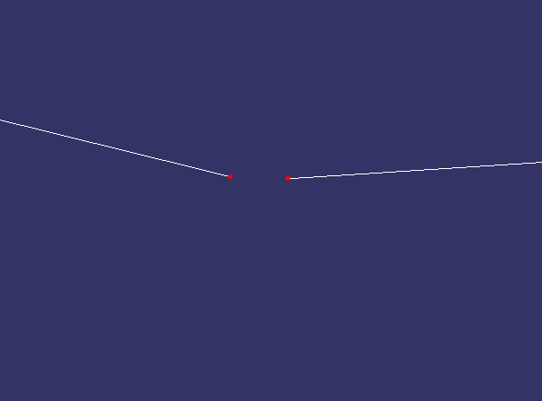

open edge in a surface is an edge that does belong to only 1 face ( the face is the subelement of the surface).

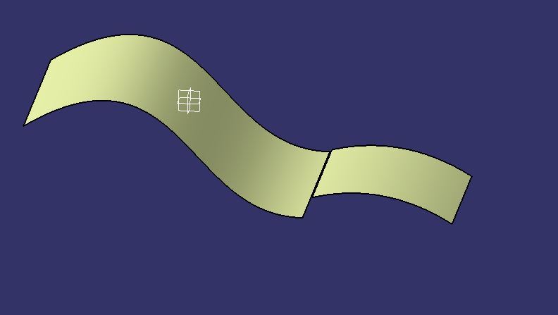

in the following example we have 2 surfaces (each surface is mono-face here. the join will be multi face surface)

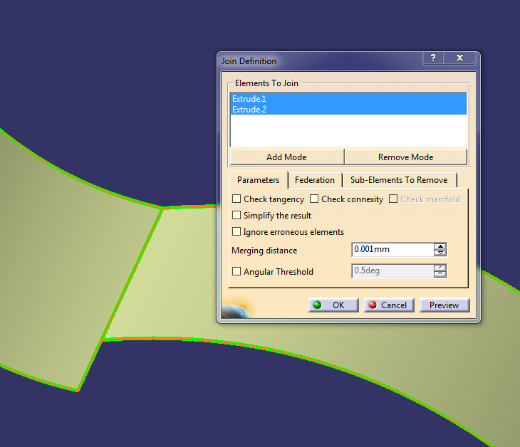

This is the join, the distance between faces are bigger than the merging distance 0.001mm
you see in green all open edges

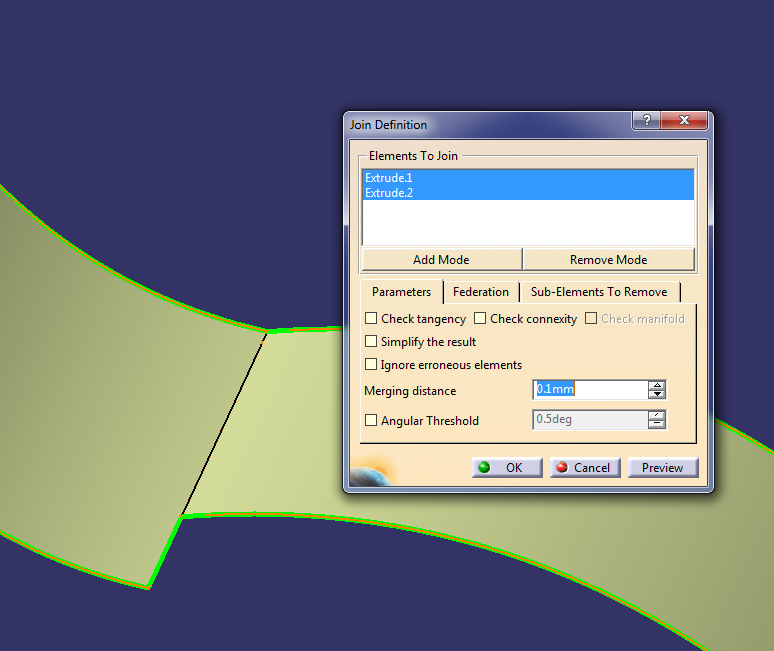

we can increase the merging distance up to 0.1mm, here is does work and the join show new open edges:
This will work for surfaces away from each other of intersecting surfaces.
I prefer to increase merging distance in JOIN than using HEALING.
