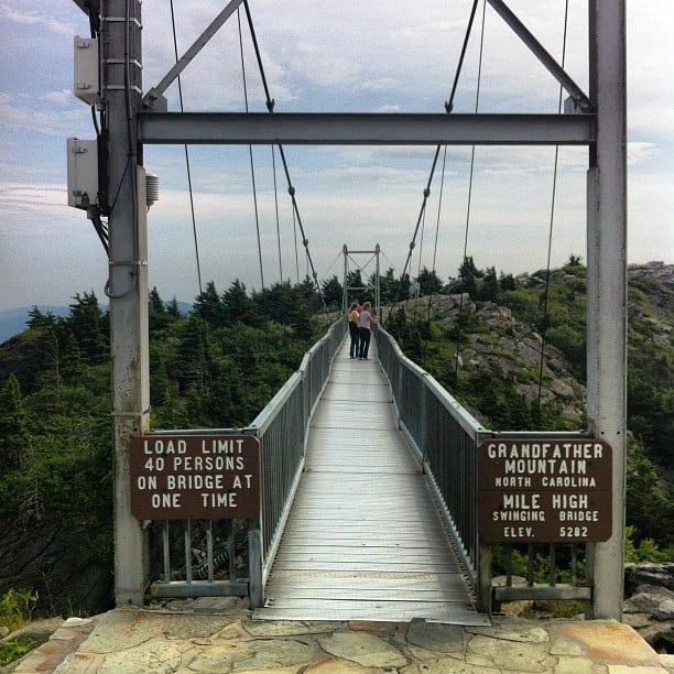

Thanks, GBS29X and Archie 264 - That photo just shows that the idea of a posted limit has been around a long time, but based on current observations is not used very often. I have done some extensive looking around and have found two modern posted limits, one (that I though I remembered from trip) at Grandfather Mountain in North Carolina:

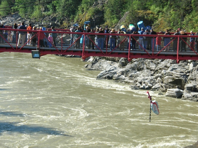

The other at the Hells Gate pedestrian bridge in British Columbia:
Looks like this one is really needed, too:
Note that both use Bridgebuster's excellent suggested "occupancy" that would be more understandable by the public.
