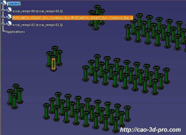

Excuses I speak very little English , I use an automatic translator .
For your problem, you must select the top assembly :

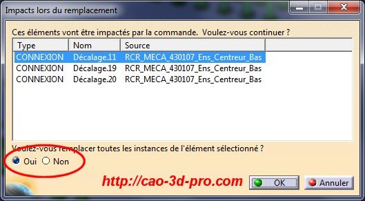

Then the screen you tip your play and you select (in french) Edit> Components> Replace Component :
In the next dialog you select "yes" and you valid OK.

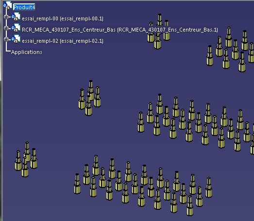

Result , the piece has been replaced in all open assemblies in CATIA:
