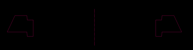

Hi everyone,
I was assigned with the task of designing a big part made of lead. Cylindrical, around 2 meters long and 1 meter diameter, 300 mm wall thickness. Here some pictures:
http://files.engineering.com/getfile.aspx?folder=2...
http://files.engineering.com/getfile.aspx?folder=b...
One can see there are also some "shark teeth" (name given by my colleague), these funny outer cylindrical angles.
The aim of this part is being an active shield for radiation (high energy particles). There will be a cylindrical aluminium alloy or stainless steal support inside to hold it. The total weight is about 11-12 metric tons.
The main problem is how to manufacture such big part.
I came up with two ideas.
One is making small parts like tiles with can be bolted to the inner support. These will be easy to manufacture, and not so heavy in order to install them.
The other option is casting; melting the lead on a mould (using the support as part of the mould would be ideal).
Apart from the lead we can also use tungsten for the teeth section since it is not so soft.
What do you think? How would you build this part?

Compositepro, this is just a shield. it has this funny shape because it stops some particles that come with a defined trajectory from bouncing. No thread or mechanical function.
Kenat, very interesting the idea of filling with powder/balls, noted and I'll ask if this works. Also the polymer
Mintjulep, rb1957 (and others) ok, the idea of bricks/staggering seems to be more liked than casting
Berkshire, Our workshop has experience machining lead, I'll check with them if pure lead is better or with some other components
Itdepends, The cylinder will be in horizontal position, static. The shark teeth to stop some particles from bouncing. The material must be lead or tungsten (which is much more expensive). Maybe the teeth can be made in tungsten and bolted/welded.
btrueblood, Good point, also noted the info about the Sb. I want to run a simulation to see how the lead behaves because it's own weight.
dhengr, It stands horizontally. The loading procedure is to be defined by us. Unfortunately I work with physicists; they fix the rules and I have to build it. Of course there is some room for changes but it needs to be checked. The tolerance/precision doesn't have to be so high. The teeth are to stop particles coming in a particular path. This lead part will be held with an aluminium allow/stainless steel (non magnetic) support, just for one side, here some tentative design:
http://files.engineering.com/getfile.aspx?folder=7...
I like the idea of the tooth-ring assembly. noted!
Timlord, yes, somebody mentioned something like this, I'll check with my colleagues if this also works (vs solid lead)
tbuelna, Yes, the rings idea seems very nice. Do you think they come out of the mould with good precision to fit them together? Do we need machining afterwards? Your sketch looks very nice. About the price I thought it was cheaper, like 1$/lb. After defining the shape and the mounting/building options, we of course have also to look at the costs.
Greglocock, about health and safety I'll check with the manufacturers, but I found companies casting lead, they should know about this. The wire winding idea seems also a very nice alternative (like the housing powder/ball filling). I'll ask, because I have colleagues who built copper solenoids and have some winding experience. About literature I didn't find anything, I'll check deeper, but building such big parts of lead is not so common. I saw a lead casting company which can make parts up to "just" 100 kg.
About lead vs tungsten. They are both used in this field (particle accelerators) because of their short radiation length. Tungsten is better (for this property, but also because it is harder; it doesn't deform easily), but more expensive, so lead is preferred. Tungsten is used to make collimators.
Thank you all very much. I am really learning many things and different ideas
This shielding is to be put in an experiment of particle physics, if anyone has interest in knowing more details about the whole thing I'll be happy to explain.

In the end it must be solid, if there are pellets or powder the properties change too much (air in between).
Thin layers is good idea, I will check
tbuelna, what influence? we can load the cylinder slowly. For mounting purposes we can fix the support on the other end or making temporary parts which allow the mounting (i.e. rings entering the cylinder)
we have to make the cantilever design because we can not put material in the open end. I've been running FEM simulations and it seems the support is not strong enough, I have to check deeper.
thaidavid40, thanks for the link. but we are based in Germany I guess it would be very expensive to look for a company outside
thanks to all
RE: Build big lead part
The concern with your cantilevered support structure is probably more about stiffness rather than stress.
I have calculated like 6-7 mm, which is actually pretty much
racookpe1978, about the radiation I don't have much knowledge; just that we must use materials with low atomic number (aluminium is the typical material to be used, it doesn't get activated so easily). I have colleagues with experience in this, there is radiation here everywhere and this is taken care
